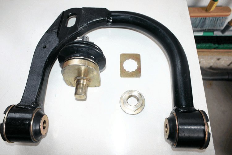

    How do you adjust UCAs? I have the TC ones and there are no adjustments that I can see.

    Those don't adjust, the LR ones do because the ball joint can be swiveled a few degrees.

    I don't think yours are adjustable.
    Here is the LT racing adjustment for castor, simply rotate the ball joint.
    For camber adjustment, the ball joint will slide in a slot on the arm itself.
    If you look at the picture you will note that there is a slot in the arm that allows the BJ assembly to be positioned for desired camber. The star plate you see just to the right of th BJ assembly can be rotated so as to positioned your spindle such that caster is affected. I don't know of any other UCAs on the market that allow this style of adjustment (that are compatible with Tacomas, that is.)
