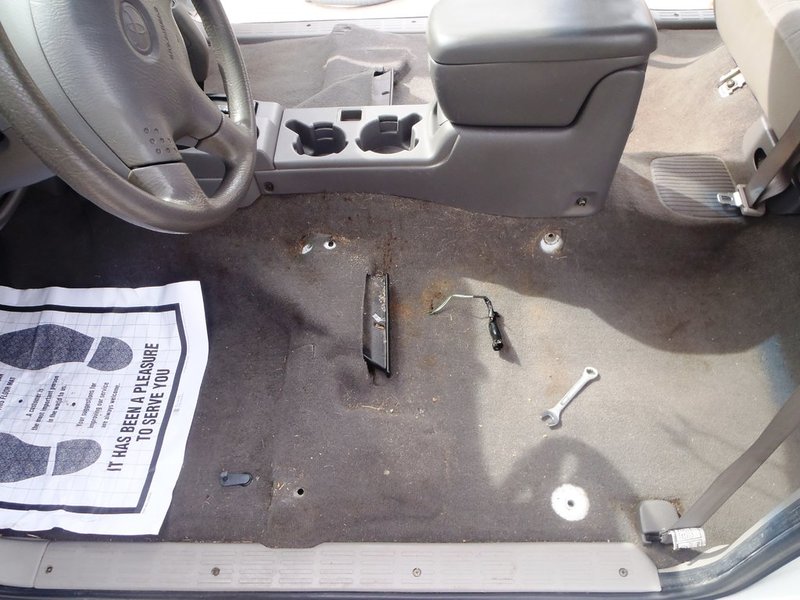

  17. Jan 28, 2016 at 1:39 PM
    Aquatic Tacoma
    Aquatic Tacoma Well-Known Member
    Mar 10, 2011
    #52776
    858
    Odessa, Fl.
    2019 Tacoma TRD Sport 4x4 Dbcb , 2004 Tacoma S-Runner
    Both are Stock - built correct from the start.
    Bought a Double Cab from a local dealer. When I get a "new" vehicle I remove the carpet and pressure clean it out in the yard. This is what I found in a dealer prepped vehicle. Not real bad but not my standard.
  18. Jan 28, 2016 at 1:42 PM
    WheelInTheSky
    WheelInTheSky Ramblin' Man
    Mar 4, 2015
    #150086
    5,198
    G
    Jackson Hole
    02 XtraCab 4x4 SR5-speed
    :confused:
    Tell me what I'm looking at..
  19. Jan 28, 2016 at 1:44 PM
    Cr250jumper
    Cr250jumper Señor member
    Dec 2, 2010
    #47033
    11,968
    The moon
    50 shades of tan©
    Tacoma with some stuff melted to it
    I guess under the seat is kinda dirty
  20. Jan 28, 2016 at 1:46 PM
    WheelInTheSky
    Mar 4, 2015
    #150086
    5,198
    G
    Jackson Hole
    That might be it, but I feel like all the stains are visible with the seats in anyway..
