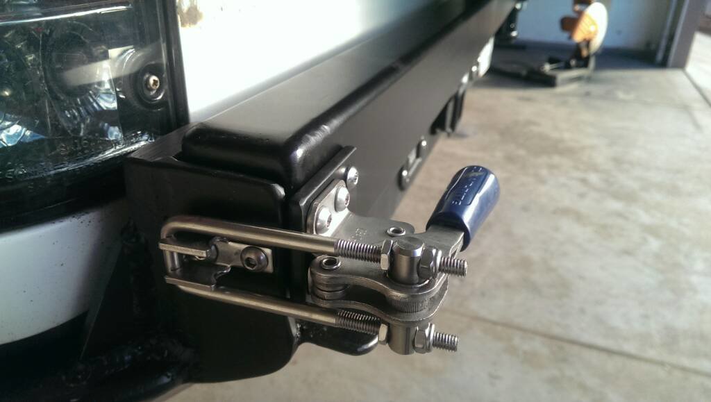

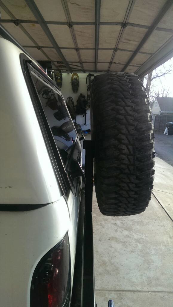

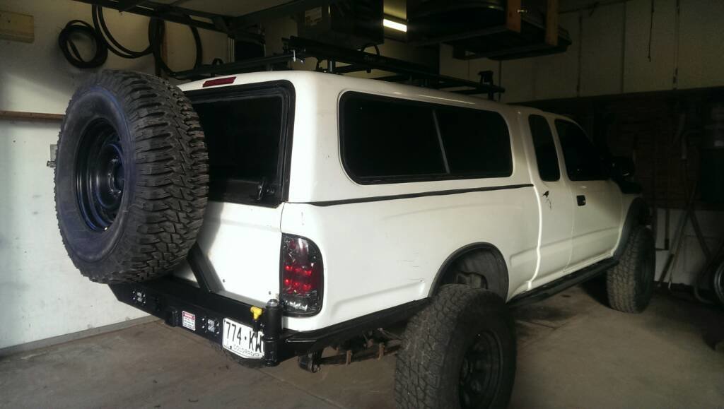

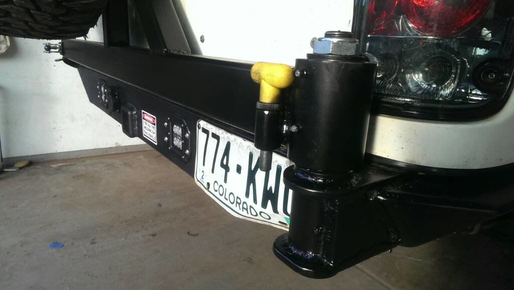

    Added a tire carrier to the TacoAss. Plans for it include adding a plate for the pop pin (didn't feel like doing anything with that today). Will eventually build some jerry can mounts, and might do one on the passenger side, and CO2 on the driver, or just one can on either side.
    Might just put the CO2 in the bed.

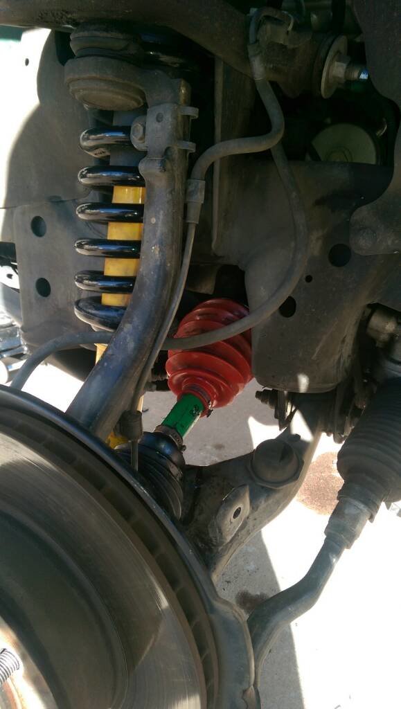

    Not a day goes by I don't find myself thinking about . . . ORS high angle poly boots! Just sayin' . . . :notsure:

    Super good investment imo...I ripped one on the small end but that's because I broke my cv (popped a snap ring and tulip felt apart) which allowed only the axle shaft to turn and the piece going to the diff and I had to drive home 70 miles which tore it by the small clamp! But love the boots! Especially with the boot slide mod!

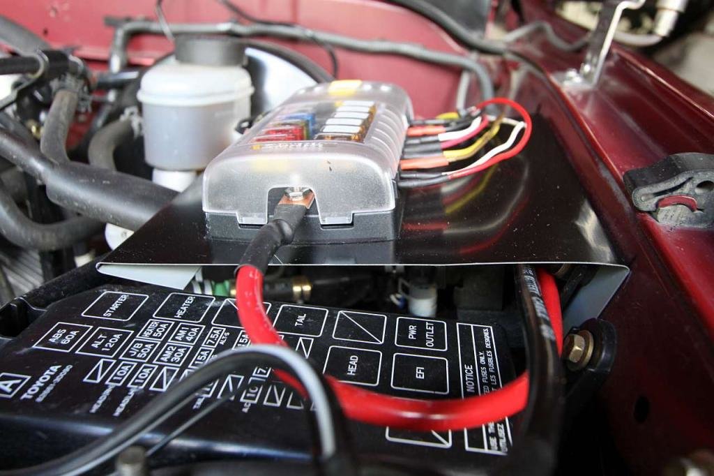

    No, in the '02 model, Toyota moved a lot of the emissions stuff to the back, under the bed, on top of the fuel tank. No canister under the hood but there is still stuff under that shingle so the space isn't wide open. Here's the only pic I have that gives any more detail. Unfortunately, it doesn't show much but you can see a little under the shingle.
    Not sure what the best method is to keep it clean(er). I just try to pressure wash it after wheeling adventures. It helps but over time it gets less clean even after pressure washing.
