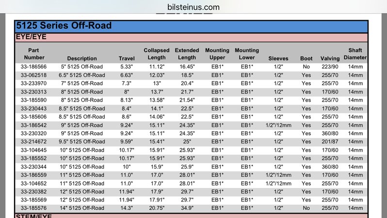

    Soo I wanna get some bilstein 5125s and was getting some prices and they asked me when ones I want. They sent me this chart, I don't know what ones I will need. Just a basic 1.5 to 3 progressive AAL. I don't know if you need to know more information or if it's just whatever I prefer.... Thank you image.jpg

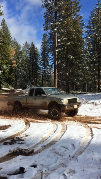

    replaced Fox/fabtech shocks with Fox factory 2.5 coilovers with resivoir w/ 3in lift. also with it installed Camburg UCAs. hindsight probly should have just got a locker and rebuilt the previous shocks.. oh welltaco time.jpg

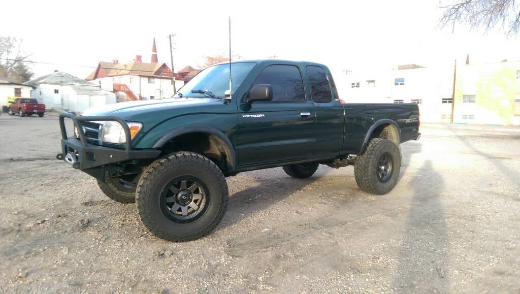

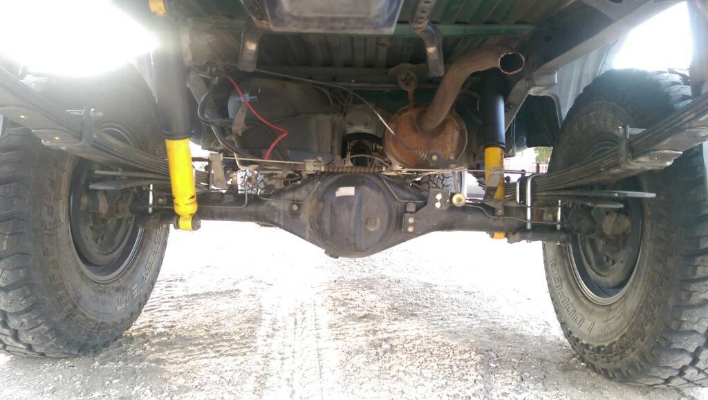

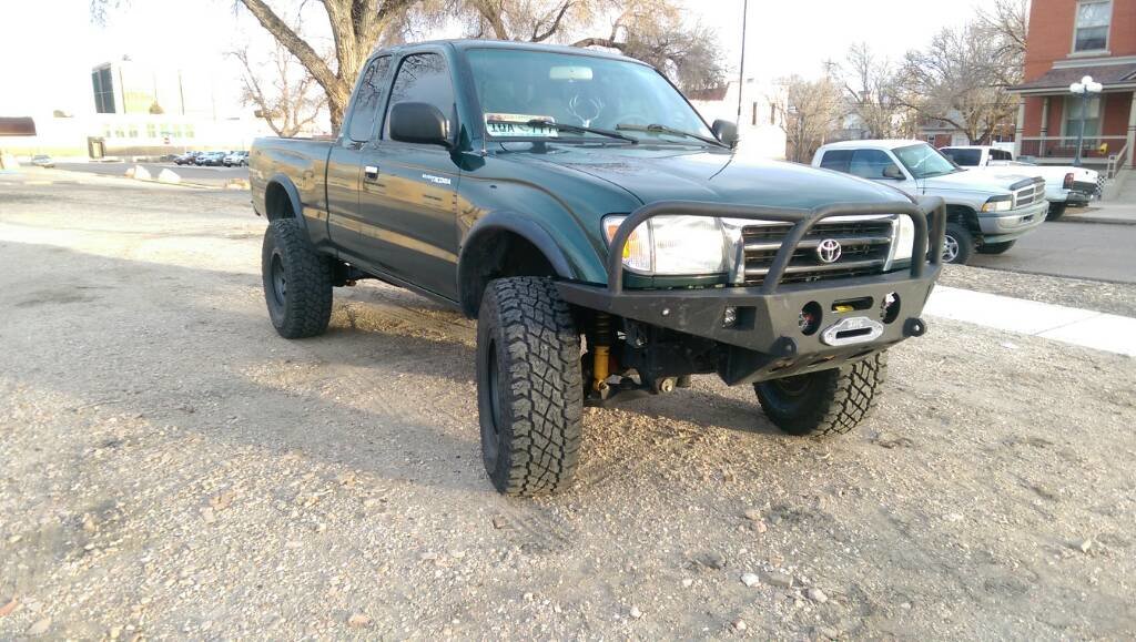

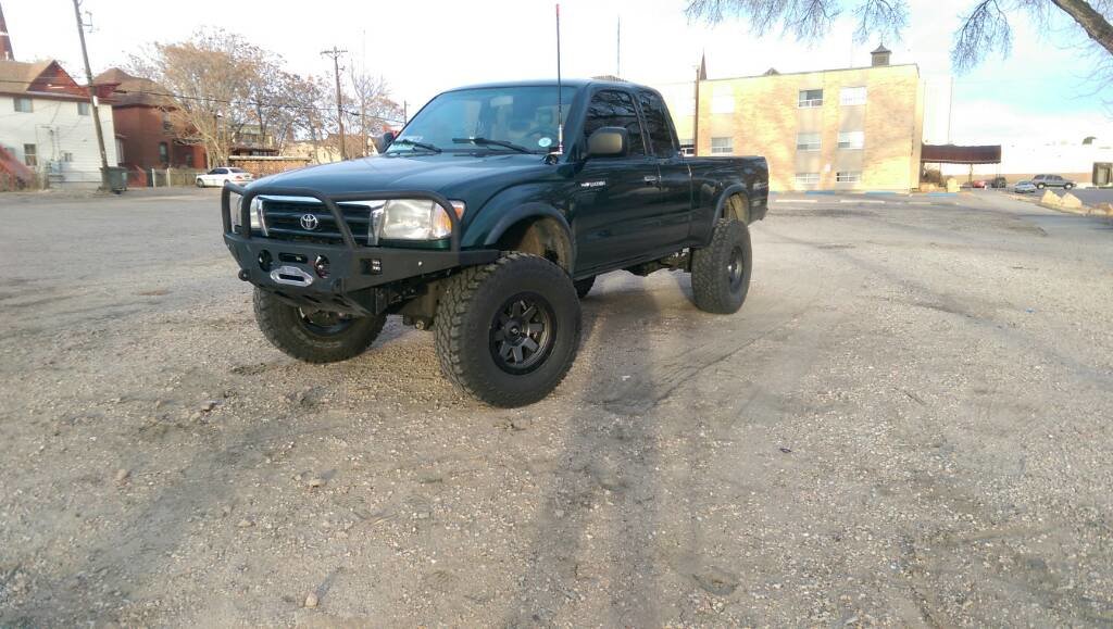

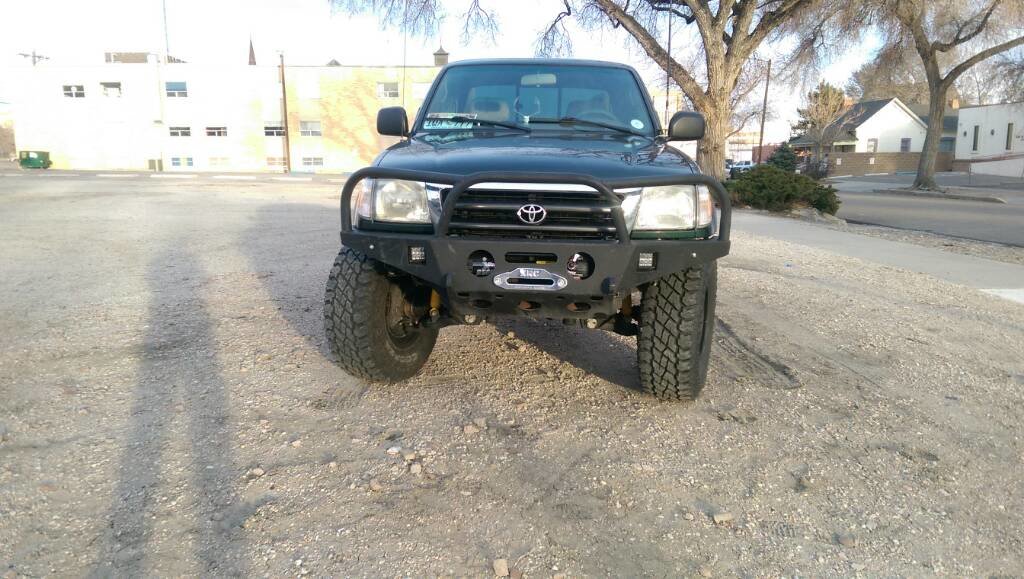

    Got some poser pics! Its clean and I need to dirty it and break the trail virginity!! Rear is all strapped up with OME again! TG Rock sliders sitting in the garage for like 2 months because I'm going to bedline rockers first! @PcBuilder14 @Speedytech7

    Any of the 8.13 travel or 8.4"

    Thanks!!! Me too! Bias perhaps? :D

    :drool: Looks awesome! You need some skids! ;)

    Next years tax return! I have my stock skids but took them off to get my alignment and working on the front!

    Nice! Gonna get full skids or just the front one? And what size tires do you have?

    I was told 10" by someone else. Is that too much? Or what's the reasoning? Just curious sorry.

    Most likely a full set! 285's! They look a little small too me because these coopers run a tad small

    You have to measure your full compression and droop. But also make sure to have the correct bushings put in so they fit your shock mounts. I have 5125s right now so I can answer some questions if you still have any.

    Gotcha! I'm gonna make some belly skids soon. No they look nice! Wish I would've gotten 285s, not 265's....

    Well what ones did you get, I don't have my lift yet and want to get it all on in one go.

    I might come up with a design my selff for belly's and just order ifs but idk yet! Yeah I like these tires a lot! well you live and learn lol

    I waited until after so I could measure. I have 11" on the longer side and 10" on the shorter side (one mount is lower than the other). But my lift is, shall we say, excessive in the rear. It is perfect at the moment shock absorber length wise for me, but if I hadn't measured I doubt I could have gotten them that way. You'll need the right length bump stops too to stop from destroying your new shocks.
