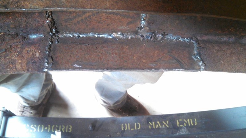

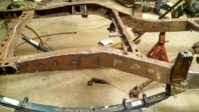

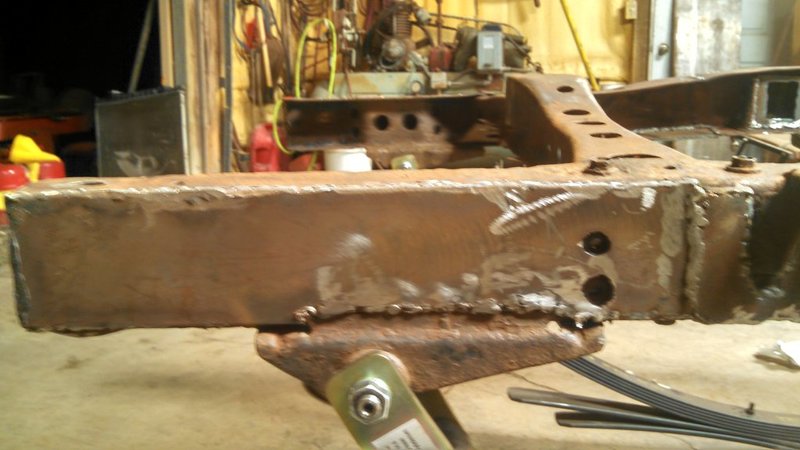

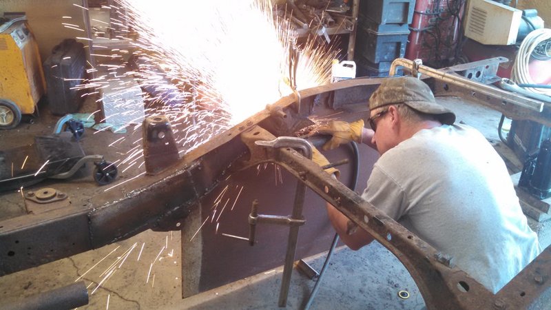

    Here you go. My dad just clamped plates to the frame the cut off the excess following the frame.

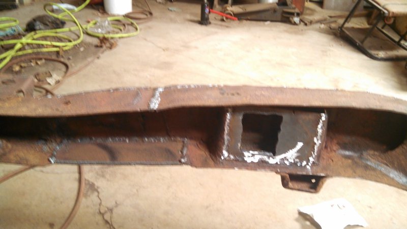

    And make sure you take your time do grind off the rust to get some good steel to weld on, other wise it will look like absolute crap as shown below. Some places are hard to get a grinder into. Some of the crap welds have to do with a leak in the gas hose as well....

    I think that'll be my plan of attack, because this is what I'm dealing with currently. It's just begging to send that leaf spring through the bed. Real shame because the other side is fine.

    Just cut her out a weld in a new plate

    What gauge metal did you decide to go for? I'm gonna swing by a shop tomorrow for a sheet.

    It's a mig, and honestly from the front leaf mount forward the frame is mint. It's in better shape than my 3 year old one on my black truck. Basically the whole reason I bought it. Sadly one soft spot right before the mount though. But it seems like a relatively easy spot to fix.

    1/8"

    I think I'll go a bit beefier than that, Nothing crazy, but I'd rather go overkill the first time. Just hoping I don't blow any MORE holes in the frame trying to weld it.

    Cut it out and weld it up, you can't really screw up MIG, especially with a little bit of practice on scrap, just make sure it's set to the right voltage, gas flow, and wire feed speed.

    Yeah be careful and keep the heat down.This happened more then once.... mostly because I'm new to welding and still learning.
    And make sure what your welding too is solid

    1/8 would be fine, you can go 3/16 but I think that would be way overkill. You'd just be adding weight.
