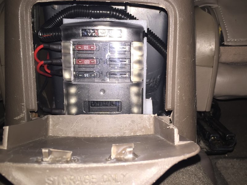

    Added Blue Sea fuse panel inside back of center console. Repurposed the little storage on the back of the console that my kids used as a trash can... Reused the clips that stopped the door from opening too far and they now hold the door closed. Reattached with some CA glue. One 2 gauge power wire from battery to Blue Sea 70 amp breaker into cab. Using negative ground behind drivers kick panel. I'll put one under hood too for external stuff but since working on stereo related crap thought I'd get this one in first.

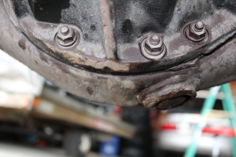

    That's why I welded a piece of 1/2x1/2 steel there, and will be rebuilding up the ring with some more welds.
    I have no interest in a diff diaper to collect dirt and loose even more ground clearance.

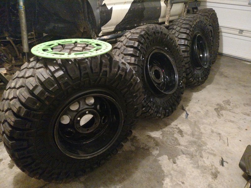

    Mounted my tires by hand... what a chore that was. These sidewalls are ridiculous
