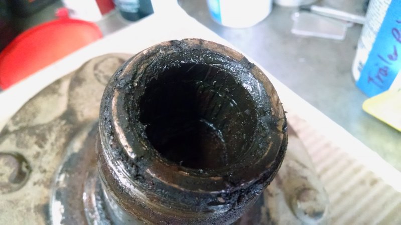

  6. Feb 24, 2016 at 6:54 AM
    Deathbysnusnu
    Deathbysnusnu Work is just a daily detour to happy hour.
    Oct 4, 2013
    #113825
    17,363
    Brett
    Fort Crawlins, CO
    Vintage Tundra
    Dog, camper.
    Hub spindle with inner race still attached.
    One of the brass bushings and the inner bearing for the CV shaft.
    tibblits920 likes this.
