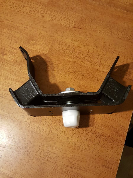

    Replaced my transmission mount today. Quick backstory: I replaced my driveshaft center bearing recently and it looked like the entire assembly was riding low inside the new center bearing. I was worried this may cause premature wear. I noticed my original transmission mount had a lot of play so my shifter would wobble a bit at higher speeds. Anyway, popped this baby in and everything looks centered now underneath and my shifter wobble has been reduced. Not much on here regarding replacement of this unit so I was considering a short how-to on it. Feel free to reply with any questions or feedback.

    I was wondering what brand did you decide to go with? I've been considering doing the same thing to mine.

    I went oem. I like to use oem whenever possible.
