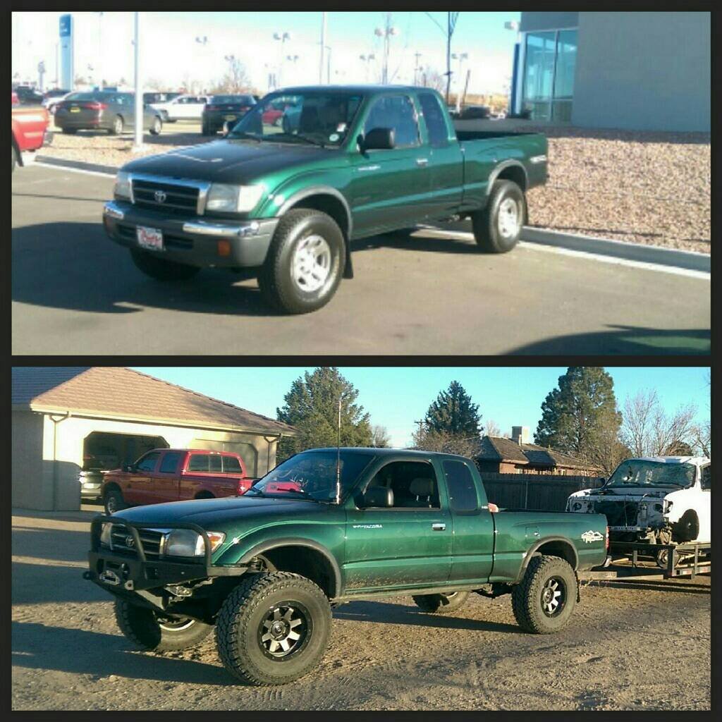

    Was bored so did this comparison from when I bought it to now which is about 2 months.
