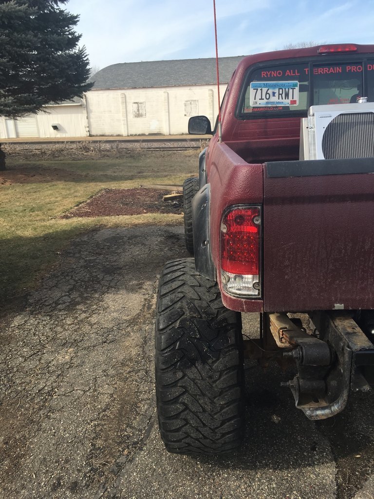

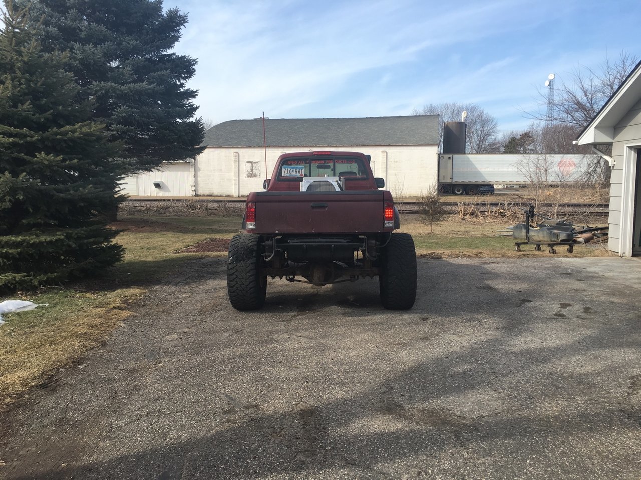

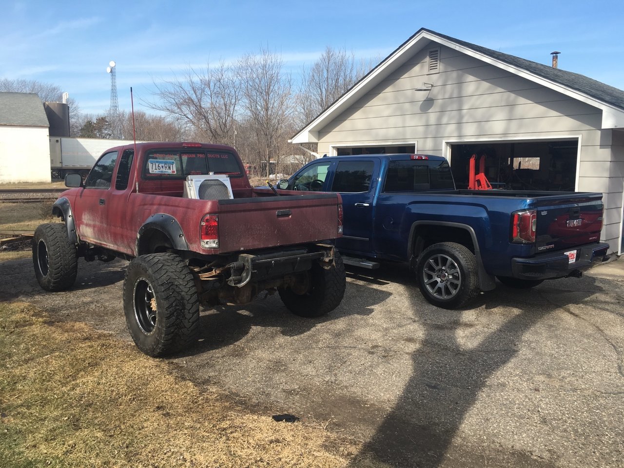

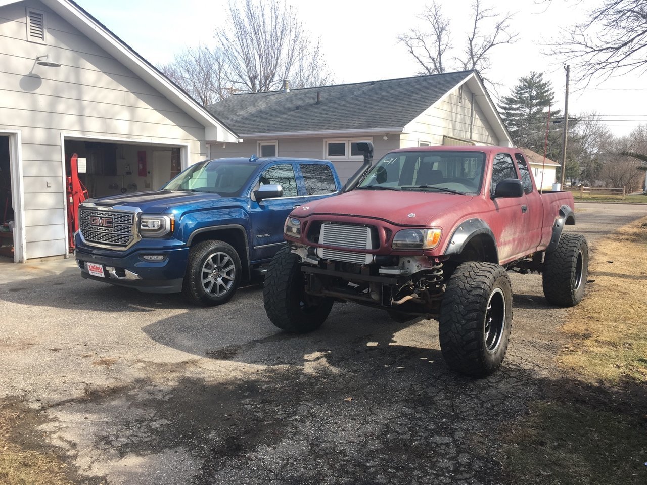

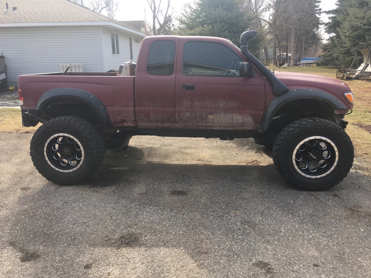

    Installed some extremely cheap 38x15.5(rear) and 38x13.5(front) Toyo Open Country's. It gives the truck a nice stance! Now I am ready to start laying out the 4 link.
