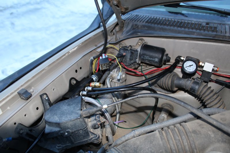

    That's an awesome idea. What's the volume of the slider like in real world terms, eg "can fill a 31" tire from 18 psi to 35 psi..."
    Love this idea since that space in my engine bay is occupied by sky gears box.

    No 35s for me. I wheel more than most on here and still can't justify the added costs, effort, and wear and tear. Plus I have 4.88s in hand now and want to stay overgeared.
    I'll test, but the heart of this system is still my Viair 400H that is mounted in that location. Don't think the 1.3 gallon tank would do much on its own. It was setup to compliment the system, being it was easy and already there.
    If you used all the tubes of both sliders as tanks it might then you might have enough volume to make a bigger difference.
