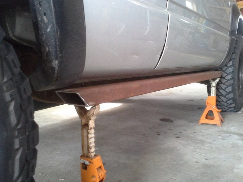

    I'm gonna try to make sliders kinda like this since I don't have a tubing bender. Any suggestions on wall thickness ? I don't get free stuff at work but the roads and dumpsters in the oil patch are loaded with so much steel and iron. Material is free if you stop and pick it up off the roads.

    The thickness your looking for is 120 wall or 3/16. You could use 1/4 but that's a little overkill. I see a lot of square tube used for sliders or even rectangle tube. It's all up to you. There is no right or wrong way. Also make sure you gusset the tube coming off the truck frame. It will help a lot. Good luck feel free to hit me up with any other questions.
    On this page you'll see a buddy of mine square sliders. They look nice. If I was to redo my sliders I would go this route.
    https://www.tacomaworld.com/threads/ps78-build.161491/

    Seriously? 3/16? That's as thick as the frame iron. 14 gauge would work just fine. What am I missing that it needs to be that thick?

    The point of sliders is to take the beating so the body doesn't. At times it may have the entire weight of your rig on it. How strong does it need to be is up to you and what you want it to be capable of handling... Even the frame isn't always strong enough...

    Definitely a minimum of 3/16". Mine are 1/4".

    Ok, good I was thinking at least .120 up to 1/4" leaning toward whatever is free. Who cares about weight I got plenty of power with the Supercharger:burnrubber:

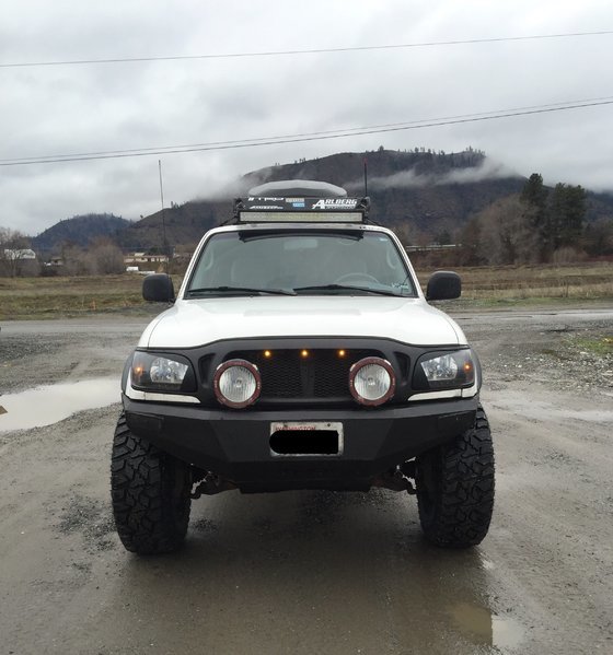

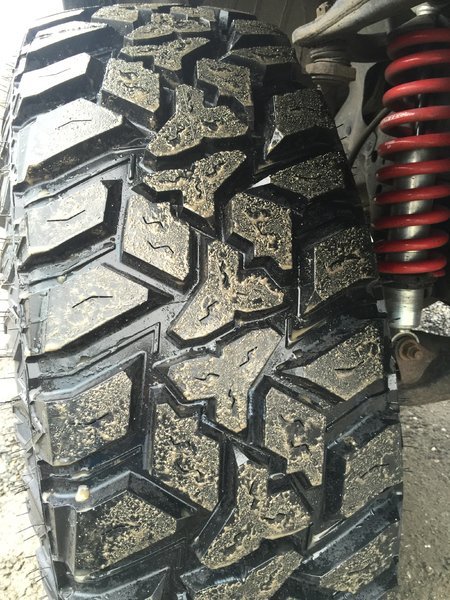

  15. Mar 12, 2016 at 9:37 AM
    BroTaco
    BroTaco Well-Known Member
    Feb 1, 2016
    #176780
    136
    Ian
    Cashmere, WA
    2017 TRD OR
    Fresh new kicks.
    I thought I would try the Cooper Discoverer MTPs (285/75/16).
  16. Mar 12, 2016 at 9:48 AM
    JPinFL
    JPinFL Well-Known Member
    Nov 16, 2015
    #169817
    918
    '01 Tacoma Xtra Cab 4x4
    @BroTaco Dude...nice truck. I am digging that front bumper. Any more pictures?
