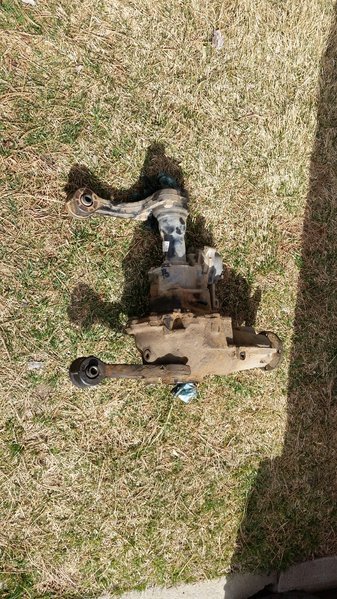

    I can say that i never ever like pulling my front skid..ever haha Bell pans can be designed so they drop pretty easily though.
    ..yeaaaaaa....:anonymous: not a light weight that's for sure...

    That back bolt mount is a PITA. Sucks to get it in more then take it out really.
    Are you doing it yourself? the regear?

    Noooooo, I'm dropping the diff and gears off at Toyota Monday morning. And that was the exact bolt that gave us trouble. Ended up just unbolting the entire mount it sits on, after which the diff damn near just fell out.

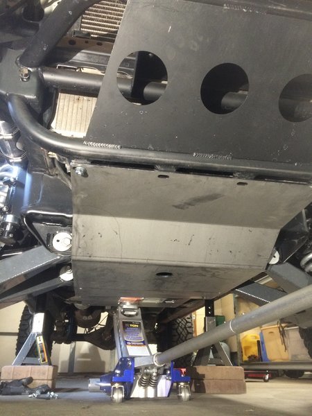

    Mocked up, removed and primed. Time to go watch the smoker and drink beer the rest of the day.

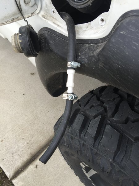

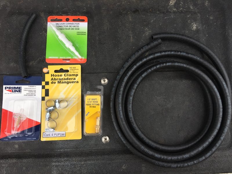

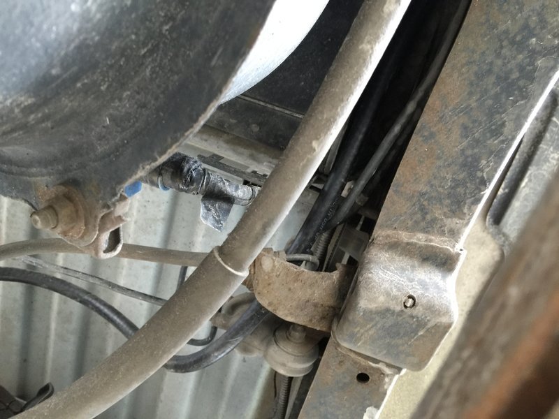

    Finally did the diff breather relocation mod. This was super easy and non-time consuming. Total install cost was $22 and 30 minutes of my time.
    Here's a write up of what I did:
    These are all the parts I used. I found everything I needed at Autozone, except for the small breather/filter looking thing; I found that at Orielly's. It seems like everyone uses a genuine Toyota part for the adapter that threads into the diff, however the part I found works just as well in my experience. You may notice I have the 5/16" fuel hose (8') and a 4" segment of 1/4 hose. This is because the threaded adapter needed a 5/16 hose while the breather only needed 1/4. A simple 5/16-1/4 took care of that problem.

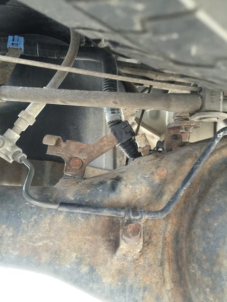

    Step 1:Locate oem breather on the diff. and unscrew it.

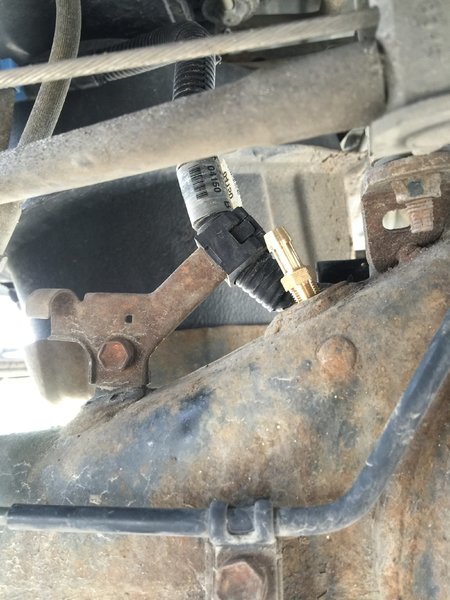

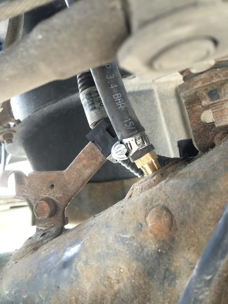

    Step 2: Thread in the new adapter. Notice the stock breather isn't threaded in completely, so I threaded the new one in the same distance.
    Step 3: Slide the hose over the adapter and tighten a hose clamp over it.
    Step 4: Run the hose up to the fuel door area and make sure you leave enough extra length near the diff to avoid ripping it out on those wheelin' days.

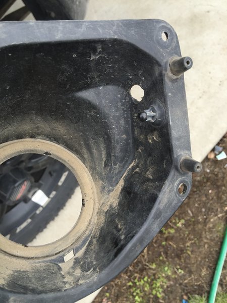

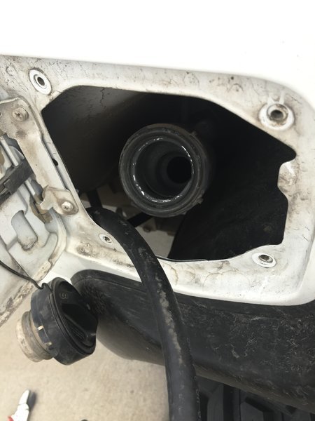

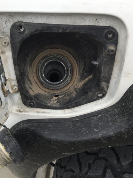

    Step 5: Unscrew your gas cap and remove the plastic insert inside the fuel door (there should be four 8mm screws holding it on). Once the screws are removed, just secure the fuel inlet with one hand and shimmy the plastic insert around it. Run the hose out of the fuel door.

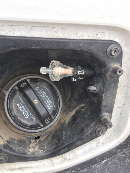

    Step 6: Find a spot on the plastic insert to drill a hole through which the hose will run. I drilled mine near the top to keep the breather out of the way of the gas cap. Here's where I had to change from 5/16 to 1/4" hose to accommodate the breather size.
    Step 7: Run the hose through, attach the breather, and hose clamp it.
    Step 8: Make sure your fuel door is able to shut completely. If it shuts, nice work, you're done. If not, maybe try pulling the hose through a little more to allow the clamp on the door to fully shut around its little knob thing.
