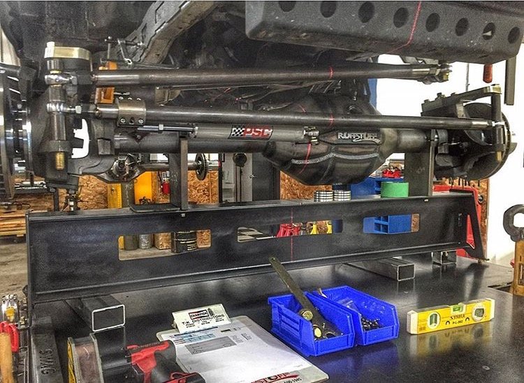

    Your going to be adding skids under that? I would probably beef it a bit and add weld washers around the bolt heads so they don't get gouged. You could keep the strength and save weight. I may have gone a bit to beef with mine as it weighs 120#.

    Skids will be after I finish the suspension. Going to tie them into the frame and mount them thay way. That's just to support the transfer case and transmission. Replaces the stock cross member.

    Haha thanks! Yeah the welds aren't the greatest. But I'm still learning. They are more than strong enough though.

    And no need to add any more beef to the cross member in my opinion. Transfer case and crawl box are on trail gears bomb proof rubber based mounts and all 4 corners are on bushing. The mounts are welded to a plate and then welded to the frame for Reinforcement.

    how come you didn't opt to clock the tcase?

    Doesn't look like there's much room to clock it and he's already into that exhaust being passenger drop. I didn't opt to clock mine because it really wouldn't have gained much, it's already above the frame and the mounts on the reduction box are massive, my frame height is right at 26" but belly pan is at about 20" that was after a ton of work to get the trail gear belly pan up about 2"
