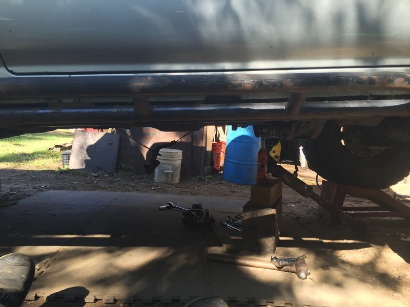

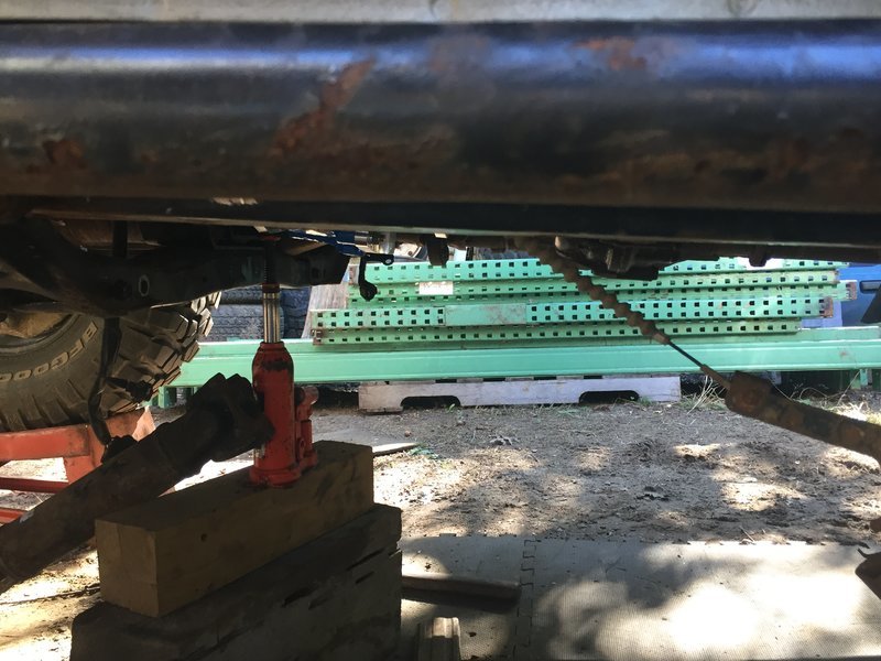

    Bayarea said exactly why. Not enough room to clock it. We tried but then we would have had to smash the floor in and a lot of other stuff. It hangs a little low but no lower than the gas tank I don't think. I'll have to wait till its sitting on all 4 tires to see. Not enough gain for all the work to clock it

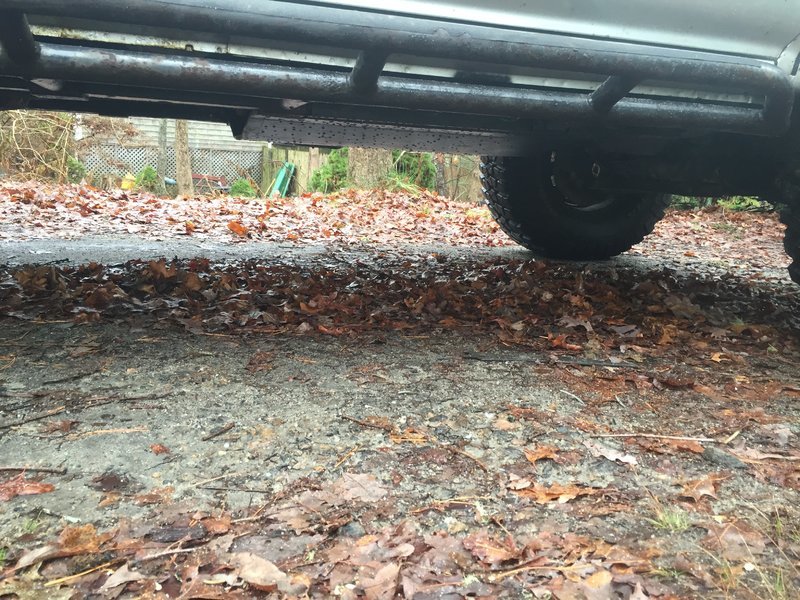

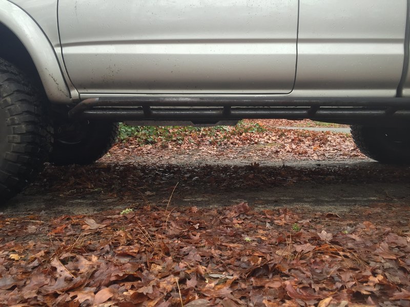

    For what it's worth there isn't to much you have to do aside from massage the floor and reroute your ebrake. The hard part is building the crossmember which you obviously are capable of. I was able to get as close to a flat belly Tacoma as you can come the lowest part is the crawl-box. Probably gained 6" over the TG skid.image.jpgimage.jpg

    His is passenger side drop so he's on the exhaust side, if I'm remembering correctly he is right at the catalytic converter. Still possible if you want to put the extra work in yes, worth it? That's up for debate. We were able to gain about 4" from the TG skid simply by modifying that. I'll be at the shop all day today and I'll post some pics of the skid.

    Curious what your belly pan to ground height is?

    That's more what I'm used to seeing or even a bit better. Flat belly pan skids. Seems totally worth it to me..

    I can measure next time I'm near it, defiantly a bit trickier on the passenger side. It's obviously not as important when your running larger tires and a solid axle as you have much more clearance. But my truck is about an 1.5" lift and 33s I need all the help I can get.
    The limiting factor when you clock it to get flat is how the drivetrain sits in the frame rails. The bottom of the crawlbox and the rear case hang under pretty close to each other. In order to get an actual flat belly the whole drivetrain would have to go up a few inches. I neglected to use the store bought second case mount as that would have cost me about 3" on its own. I opted for a weight bearing mount on the factory case instead. It won't help with twist but then again tcase mounts are not intended to as the motor mounts if functioning eliminate that problem. Defiantly interested in seeing the modified TG one, I purchased one mocked it up and didn't want to chop it up.
