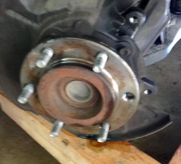

    Picked her up a few weeks ago, Tires/Wheels/New wheel stud/ Paint Drums/Lift/Bed-liner.. She is clean clean! 79K miles...1.jpg2.jpgunnamed copy.jpgunnamed-4.jpgunnamed-5.jpgunnamed-2.jpgunnamed.jpg
    JKU3000, Lux, westhumboldt and 3 others like this.

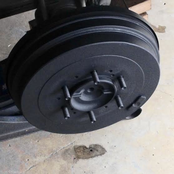

    Clay bared entire truck, got rid of sidesteps, now need to remove box tube rails and get gator Hyde sprayed on rails.
    Put a coat of meguiars gold class wax on it after this picture, and tried out the aerospace 303 protectant as well.
    JKU3000 and boostedka like this.
