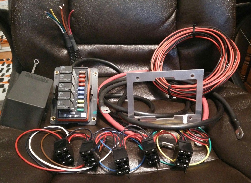

    I was looking at the Blue Sea fuse box when I found this one from Bussmann. It uses the mini blade fuses same as the Tacoma and has a sealed top. You also have the option to use mini relays, micro relays, and mini circuit breakers. Tall or short cover if you just want the mini fuses (20 circuits). Only about $60 for the one on Amazon but there are so many options that it might be best to do a group buy in order to get a distributor interested.
    Here's one wired up...
    Data Sheet

    I have one of those from a group buy on here. Its pretty sweet! Love it.

    That is sweet. I found a place to click order the whole kit in case there is no group buy soon. They have them with or without the relays.
    Question: So I think I just need a few fuses right now but what kind of application would I need the relays for? Is that for different kinds of multi-pole throws or something to do with throwing higher amperage connections?

    @Blackdawg told me its a good idea to just have everything on a relay. But im pretty sure its for sending power to higher amperage things, were the switch itself cant handle that many amps, so its just used to signal the relay.

    You use a relay so you don't run the full amp draw of the component you are powering thru a switch inside your cab. Lights and such can have a significant power draw. You power the relay under the hood instead then activate the relay with a single small ga wire thru the firewall to the switch on your dash.

    Use relays. much safer.
