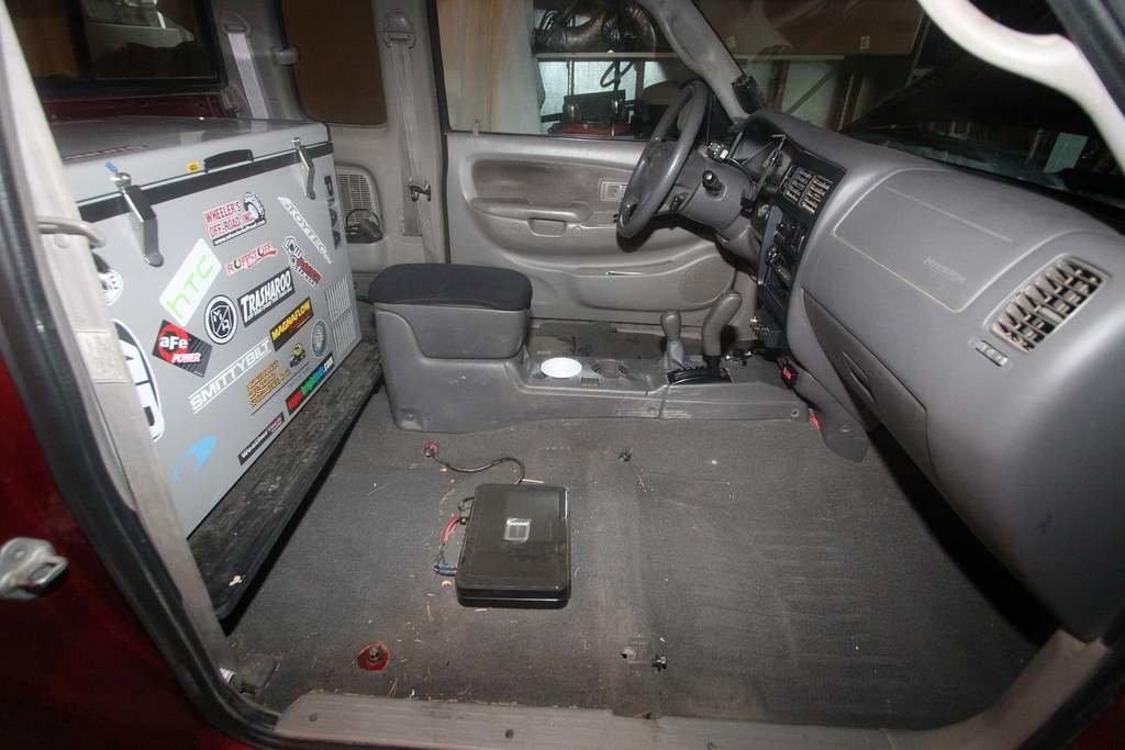

    The fridge is sitting on a painted piece of 3/4" plywood that is attached to the bench. This extends the depth of the surface and also gives a flat, even platform to work with. The fridge is then strapped to the wood platform. Sorry, no close-up pics of this.

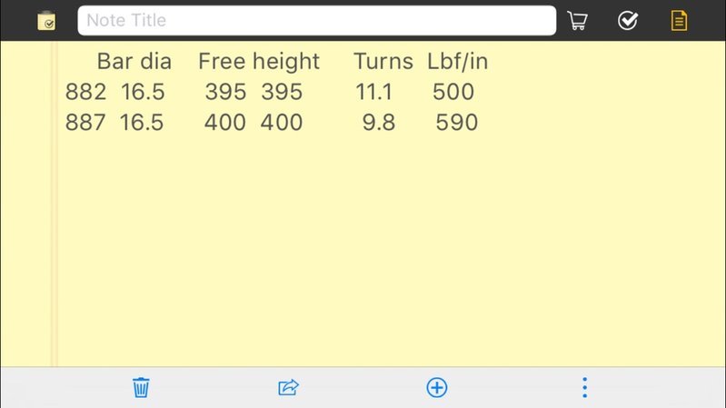

    So my front coils are starting to sag and was wondering
    What are the reasons that you shouldnt run second gen lift coils on a first gen taco
    As far as i can tell they will fit seeing as the 883 is listed for first and second gens so the coils have the same basic shape
    im running the 882 why couldnt i jump up to the 887 for instance
    Heres the information on the two different coils ive found online
    I have a 1" lift spacer for my front end but would rather buy new springs then use a coil spacer
    Thanks for any help
    Measurements if not listed are done in mm

    1. Whats there to not understand about the lift? Its basically the same as replacing the oem leafs and struts. Your usual mechanic of choice shouldnt have any problem installing.

    Cause 887 are meant for a much heavier truck. That being a second gen

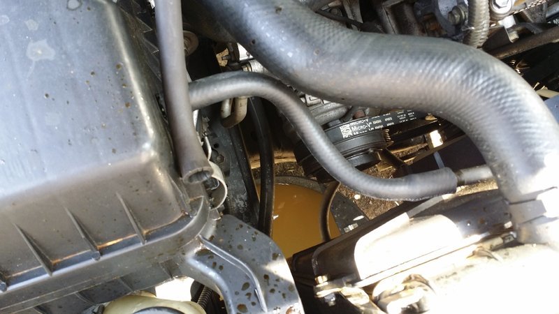

    Where did you find that hose? Mine was the same issue.

    882's are the tallest of the first gen options from OME but a lighter spring rate. The 887s have the same spring rate as the 883s, but are even taller than the 882s. Might work if you have a bunch of weight on the front, but even then it will probably provide too much lift.
