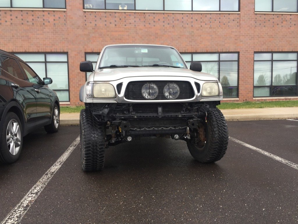

    Drop bracket lift and booger welds
    Got it back!

    Why was she gone?
    Okay so the 3.0 shaft 14" length 600lb coil? Thats a beefy ass coilover!

    gratz how does it ride compared to before?

    3" = ID of the coil spring, in this case providing .25" clearance for the 2.5" shock body. A 2" shock body would use a 2.5" ID coil and so on.
    14" = free length of the spring
    600 lbs/in = spring rate

    New frame.
    Same I guess? Actually worse because I have billy 5100's on 625lb eibachs with no weight up front right now. Gotta get the bumper, crossmember and skids back on. Also got used to how a 2016 4runner rides...

    With the new frame do you have to put that cross member on?

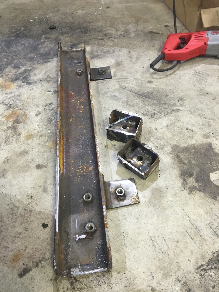

    Thank you!
    Yeah I had to cut off the crossmember we welded on and then cut out the extensions we put on too. Hopefully it will be a matter of making new extensions and slapping it on.

    Damn so all that work just to get a new frame later and then it would've bolted straight up....

    Oh no we are still welding it on. There is no way to mount an addicted offroad front bumper without welding. It would not be able to take the abuse of recoveries or heavy winching. The crush cans on a first gen tacoma are weak as shit, so the crush cans will be removed and extensions are welded directly to the frame rails. The frame extensions are 1/4" wall rectangular tube and the crossmember itself is 1/4" as well. Beefy as shit when all is said and done.

    Oh yeah Addicted off-road makes bumpers for the 98-00 frame which is about 3" longer in the front. If we go any other bumper we have to cut 3" off

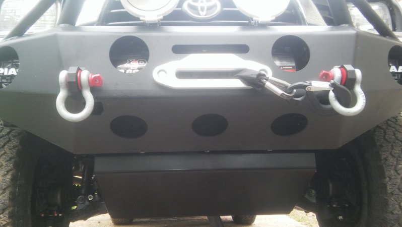

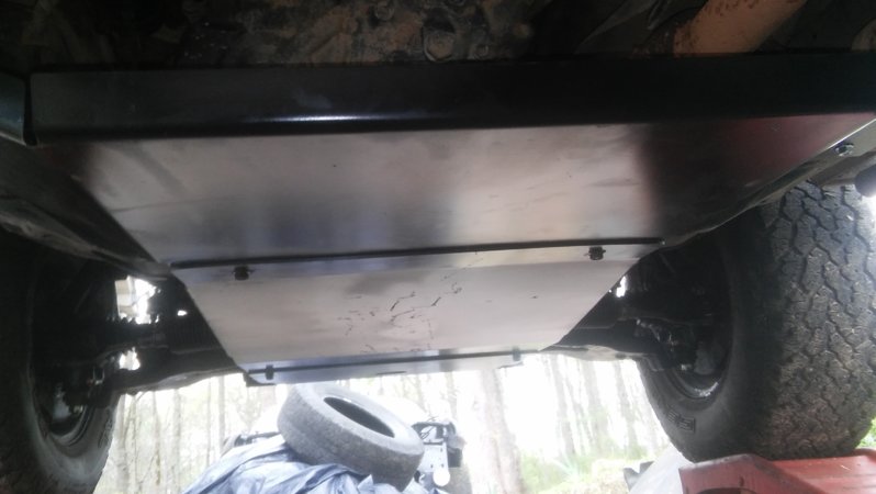

    Got my skid plates installed today!
    I have been looking for a place for my Tacoma World sticker so I put it here.
