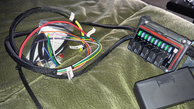

    Ordered a 15304-2-2-4 RTMR. Gonna get all the connectors and wires and stuff and go the DIY route.

    Got my RTMR today!

    So is that the same type of Idea as a bluesea?

    Similar, but it has a relay block built in as well. 5 fuse protected relay circuits and five fused circuits.
