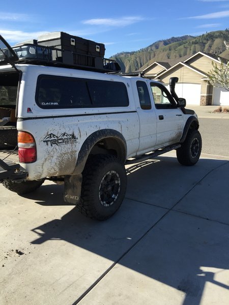

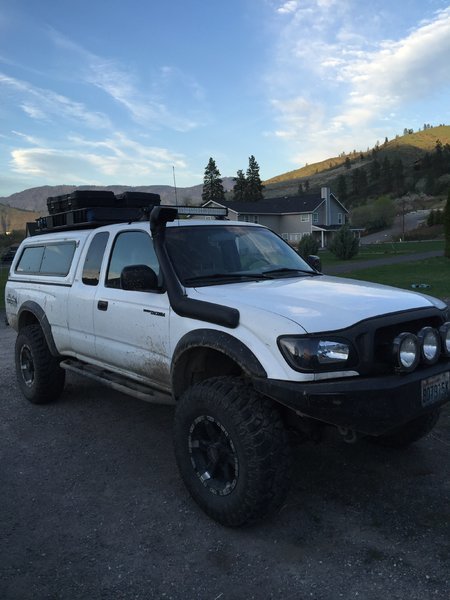

    It's less Tacoma and more mod
    Do you have a pic of the gap between fender and snorkel? Looks like it fits nicely!

    There is a small gap, the same one a couple others had. I'll get a picture of it soon, it really isn't that bad and it doesn't whistle or anything. I have some photos of the process in my build thread. https://www.tacomaworld.com/threads/brotaco-pnw-expedition-build.421077/
