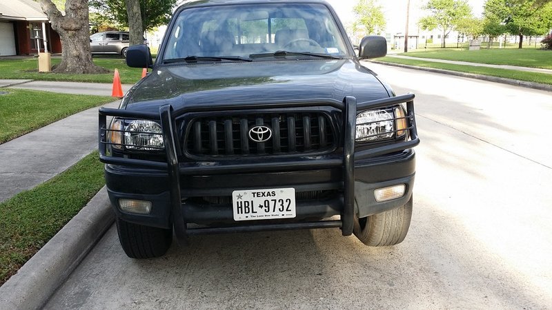

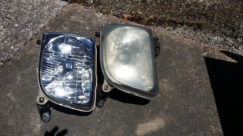

    New Headlights. No more "old man glaucoma" taco.
    The new ones are TYC CAPA certified from RockAuto for 41.79 each.
    After removing/loosening 4 18mm bolts on the bottom, then a couple up higher I was able to pivot the brushguard down. Grill removal was simple using a screwdriver to pop the clips. I am not a fan of the way the turn signals are installed, some minor piece (blue) is missing on the driver side and that one is loose. I need to align them, but I didnt bother this weekend.
    I also removed the fog lights. At least the person who put it in did a proper job, there was a relay installed near the battery.
    Maybe I will scrap the brushguard. I am thinking do a Satoshi style grill. Some hexagon mesh or something and spray paint it dark bronze.
