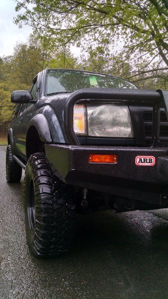

    I think I really am starting to like those headlights. I've seen em on a few tacos and some jeeps

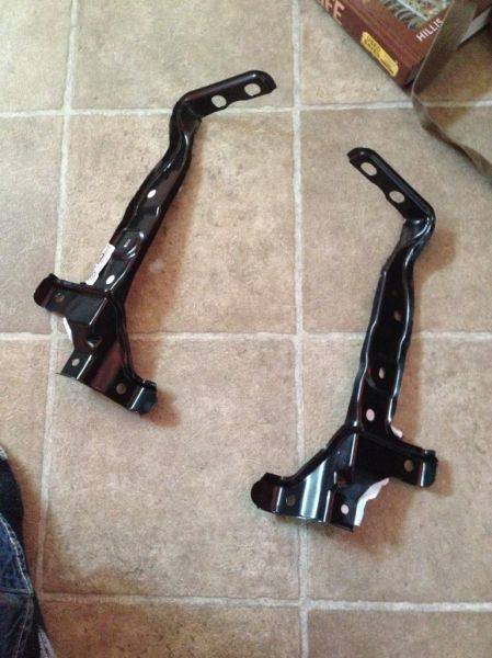

    Also with the swap - you still need to buy the fender/headlight brackets because the 01-04 headlights bolt to those and not the actual radiator support

    Yeah I kept my fenders just bought the bracket. I wish I could've made one of those but didn't have tools or material necessary for it. Would've saved me some money as well

    Bought a bracket? Have a link? Some things I'd rather buy than make

    Here is what they look like
    Part numbers
    53803-35010 right
    53804-35020 Left
    You can check out my front end conversion thread and on the OP there is a picture of what they looked like installed
