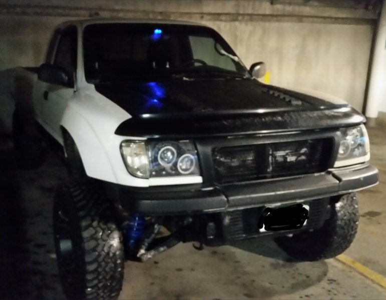

    Anybody know of a fuel cell mod or replacement to put the gas tank (not oe, but a different one) in where the spare tire goes, more towards the center and back. Any helpful input would be appreciated. Pic for attention.

    None that you can just buy. Be a custom job.

    I was just going to ask on your thread. Lol. Yeah, pretty sure you'd have to mock up mounts and run lines. With LT (SUA) do you think it would clear the axles bump? I'm willing to do it but I'd wanna see if anyone has done that before me without putting a fuel cell like against the cab.

    Humm I know of a ford fuel tank that can fit back there and I know of some guys that did it. I wished I paid more attention to them when they did the mod. I could ask them for the write up and post it to your build when I find it.

    No sure. It'll be tight and may end up being a small tank without hanging down too low.
    Possibly. Couldn't say for sure but looks like it would be

    That's cool. Gives me something to work with. I appreciate it much guys. Yeah, having the fuel cell off to the side totally throws off the geometry and dynamics of the vehicle. I'm going to look more into this. If you guys see anything else shoot it into my build. Thx.
