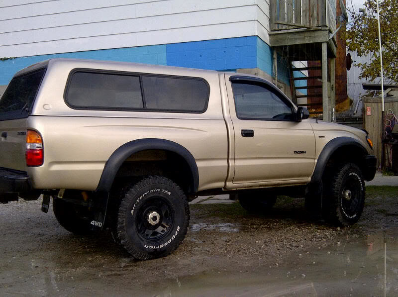

    Nice.....I put the exact same on my truck on old 4runner rims

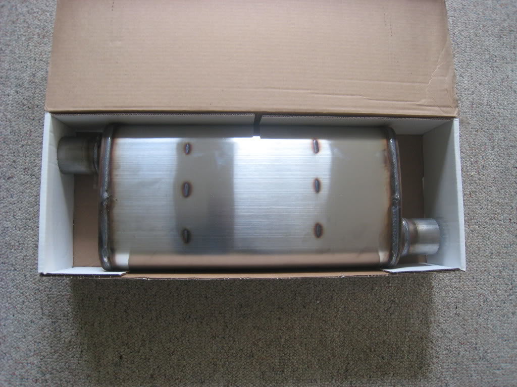

    Got the new muffler installed today, sounds great!
    It is a Magnaflow 18" XL3, Part # 13265, and I don't think I've heard any sound clips of this specific type before. Most all the types I've heard before have been the "Universal" straight through type. This one has chambers in it and is supposed to be a little quiter than the straight through from what I've been told and read.
    I had Muffler King do the install (who I've always had do all my exhaust work as they provide fantastic customer service and the best quality around for this type of thing that I can find) and said that he has not installed this specific muffler on any of these trucks before...only the universal. He said in comparison, the XL3 is deeper and quiter. I was really amazed at just how quite it really is. Infact, inside the cab, it sounds near stock only with a slightly deeper tone. I had a new section of 2.25" tailipipe routed up above and behind the framerail completely hidden out of site, painted black. Even with this set up, there is zip, zero, notta of any drone to be found inside the cab. It's too early to tell about mpg's, but overall it gives the feeling of being able to breath a little better. I'm very happy with it and it's just what I was looking for.
    Highly recommended for somebody that wants a little deeper tone, yet still being well within the ball park of having that near stock sound.
    Here is a couple of photos and what good what it do without a sound clip, so you'll see that below.

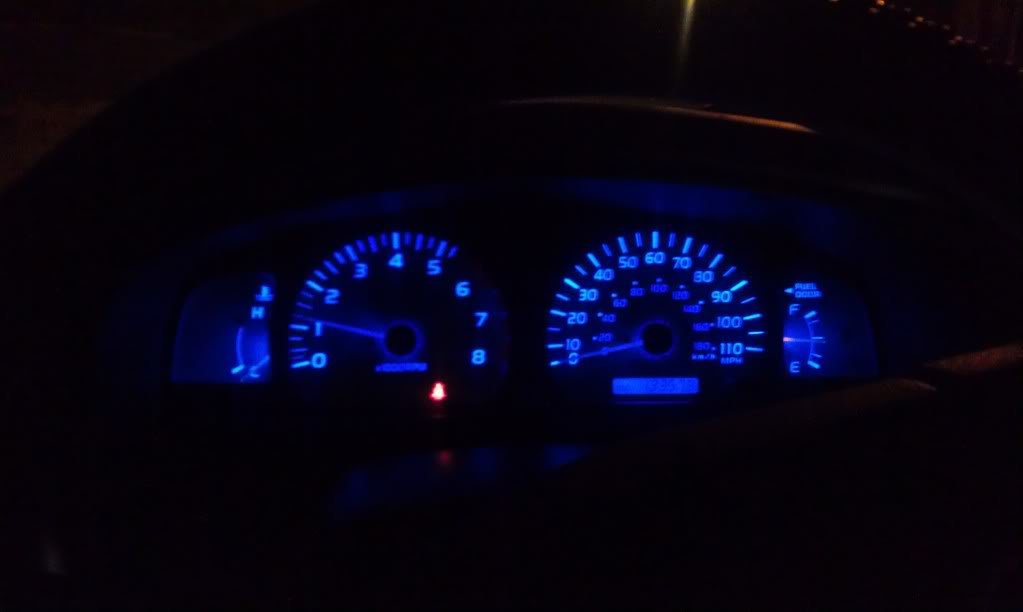

    Got my Dashboard LED's installed on my '04 Tacoma Double Cab... FYI, ordered on Tuesday, received on Friday of the same week... Also, I ordered new bases ($1/each), but they didn't work, had to end up using the original bases, so save yourself the money and don't order them... Took just over an hour including me taking off the airbag, then realizing I didn't need to ROFL...
    Find your bulbs here: http://www.superbrightleds.com/vehicle_led_bulb_finder.php
    You will need to order 4 bulbs for the Instrument Cluster! (mine were $5.95/ea)
    Easy instructions here: http://www.customtacos.com/tech/index.php?article=77

    where did you get that switch?

    what does the base you order do? do the lights not fit properly?

    It's just a replacement light base, it just goes in and twists, but not sure why they didn't work, thought maybe it was the bulbs, but I put the LED's in the old light bulb base and it worked perfect...
    Basically it holds the bulb and when you insert it and twists, it makes the connections on the computer board (well it's supposed to), there are no visible wires, just looks kind of like a computer circuit board...

    could you show me a link to the exact bulbs you bought. i ordered some and just want to know if they will be the same brightness
