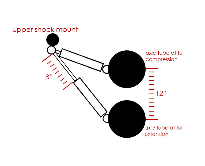

    Calling me out for making jabs and then you do the same thing yourself?
    Anyways, you seemed to miss the last line of that post you quoted, which explains that in drawing influence from others on here, yourself included, I created a functional setup, but one that is far from ideal. They'll be redone shortly to better suit my needs based on knowledge I've gained through the process and over the time I've had them setup that way.
    As has been mentioned in the last several pages, people tend to promote thing on here as gospel, and a younger, less-educated me used to take that info as gospel. I'm merely sharing my experiences as I've had them. I certainly never claimed my rear setup was ideal either.
    Yes, I am in fact smart enough to grasp the concept. But the distance of the shock travel relative to the axle travel will be a ratio dependent on the angle they're mounted at.
    That diagram is correct, given that specific angle of mounting. I've never seen a shock be nearly horizontal at full compression. That's a much more drastic angle than most of us are mounting our shocks at. It would require a lower and further back crossmember.
    I still stand by my comment that your shocks limited your vertical travel, mine do too, which was my main point to begin with.
