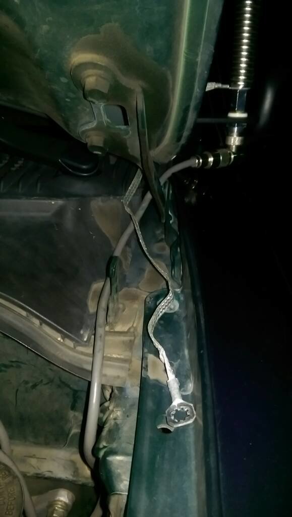

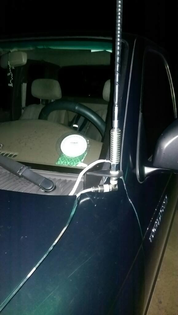

    Just took these now but I have the bottom of the ditch mount ground to bare metal which is connected to the hood hinge and then another ground cable from the bottom of the antenna to a bolt on the fender. Not currently hooked on because I broke the bolt...oops!

    Thanks man, looks like a good spot for it. Kinda wish I would've went with a 3' stik now

    Meh I've seen 4 footers in the same spot. As long as you have a good spring because it gets hit hard with winds on the highway. I have my 2 foot with the firestik HD spring and it hardly flexes at 85. Just test it you know. And if you don't like it switch to a 3 ft.

    Ya I got the HD spring should be fine
