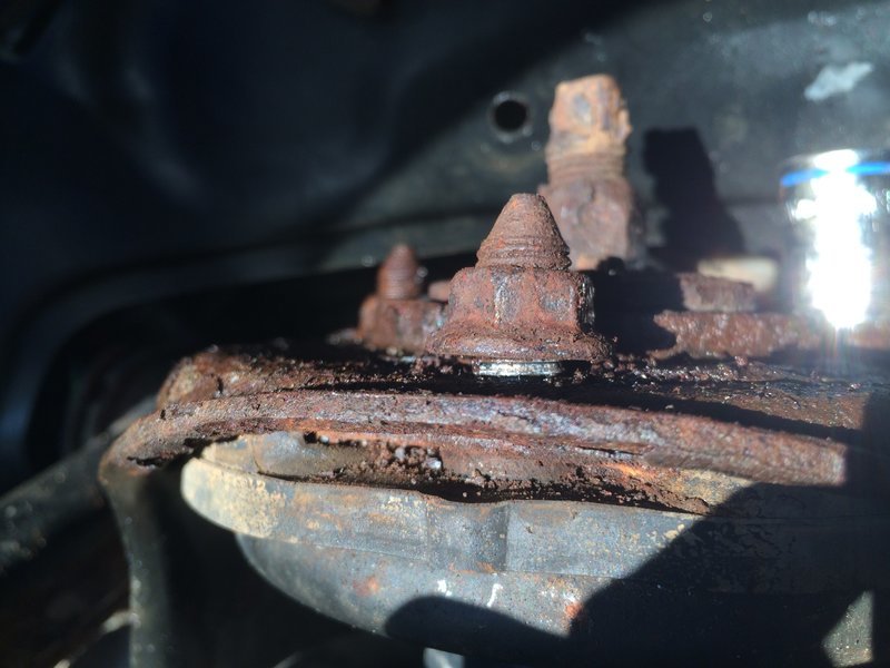

    got a little problem, I started taking apart the front end of the truck and when I started unbolting the top 3 nuts on the old coil/shock assembly the bottom rounded bolt thing started spinning right when i got near the end of the threads, seems to still take a ton of torque to get them off even on the end of the threads too. how can I get these things off? put a load on the coil somehow? Also the sway bar link had kinda the same deal theres some sort of plate on the inside that spins when I try unscrewing the nut.. Any help? thanks
    Edit: tried putting a load on the coil with a jack and it didn't help at all i guess because pressure isn't being put evenly across the whole underside of the shock mount? id have to compress it a ton to have a good amount of pressure on the bottom of those things

    Are you talking about the 3 top hat bolts that hold the coilover assembly in the coil bucket on the frame? I take the weight of the suspension and first remove the big lower, CO bolt that attaches the CO to the LCA. If you did that, I missed it in your description. The CO assembly cannot be removed with weight on the suspension on that side.
    On the swaybar link, use an allen key to keep that bolt from rotating.

    I removed that lower bolt but then how can I remove the top 3? can the shock lower enough to get a c clamp or something in there? here is what I'm looking at IMG_4395.jpg
    Not sure I understand how you want me to approach this :confused:
    maybe I should just cut the top threads?

    Yeah, I lot of rust and corrosion on those. Did you put some PB Blaster on them? If those are just spinning, you may have to cut them off.

    yea used a ton of pb blaster, just gonna cut em below the nut but idk how I'm gonna reach into the back ones because all I've got is a cutoff wheel right now, ill figure it out, thanks, 90% sure ill be back with more problems haha
