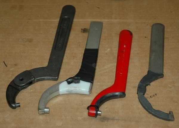

    Ok kids, I was just told I need to compress my springs in my King shocks to adjust the ride height with a spanner, is this true?

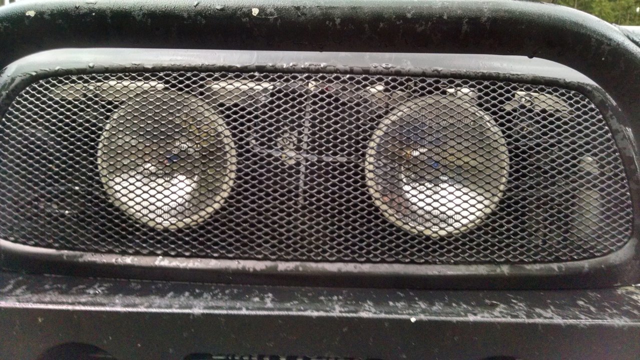

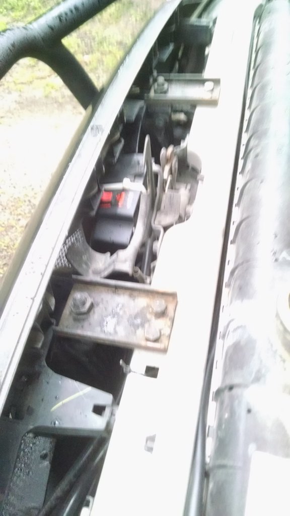

    Here ya go. Sorry for the crappy quality, it was starting to rain pretty good and phone was getting wet. Just have a couple zipties going vertical and horizontal, tied off to the vertical support right under the hood latch mechanism. Ain't pretty but it's temporary, pretty well shielded from debris and easy to plug in to.

    Shouldn't be necessary as long as you jack the truck up and get the weight off the springs. It'll take some muscle, but definitely doable. Some WD in the threads doesn't hurt, either.

    Shocks aren't on the truck... Maybe I'll order up a wrench and do it that way.

    That'll make it a bit trickier, being that the top and bottom aren't being held steady and kept from spinning. Never done it when they're off the truck... may want to use a compressor in this case, or just put them in the truck first.

    Guess I'll be ordering a spanner.

    Good tool to have for the coilovers, anyways. Makes adjusting them down the road easier, rather than trying to make/find a tool that fits in the holes without tearing them up.
    Ask me how I know...

    Yep, start a collection.

    That's the easiest way for me. On the ADS each full turn is about 1/4" of lift.
    If you unload the shock to pull the tire then there's no way to know the effect of adjustment until you put it on the road anyway.

    Because I want to put them on and not have my nose in the air. Figured It was easier.
    Anyway, spanners been ordered, shocks will go on Thursday night and hopefully alignment Friday.
