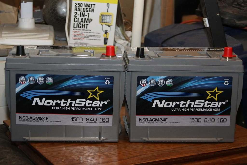

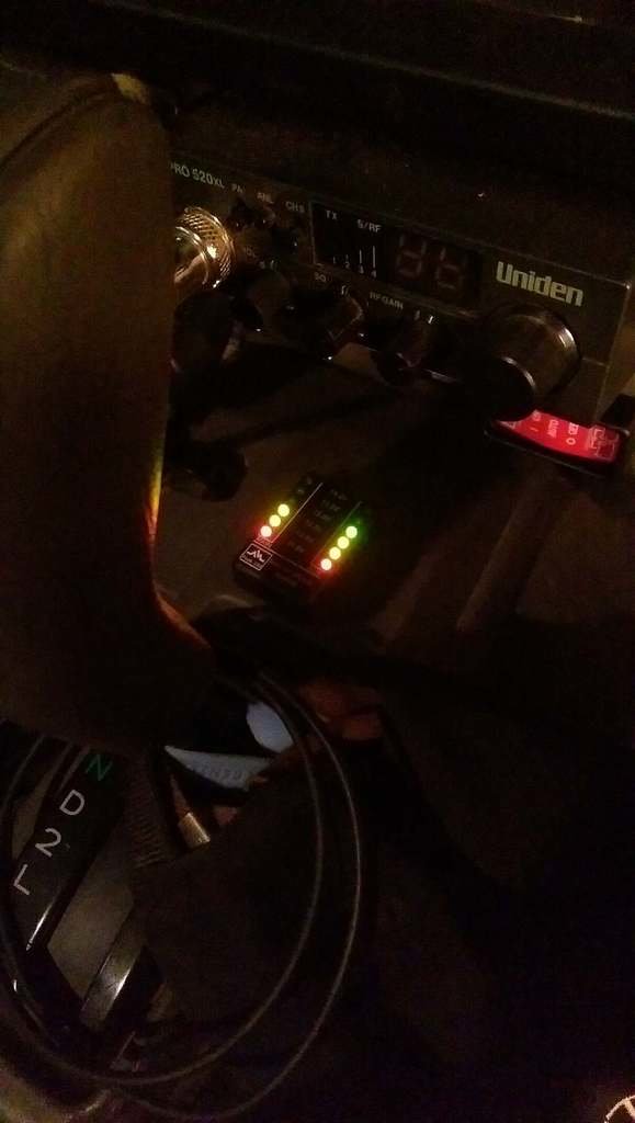

    Finally finished up the dual battery install this week. Using two Northstar 24F AGMs, one in the stock location and one in the bed. They are connected with 1/0 gauge wire running through a BlueSea ML-ACR. Voltage is monitored with a Peak DBI dual voltage monitor mounted in the cab.

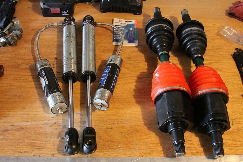

    This is today's project:
