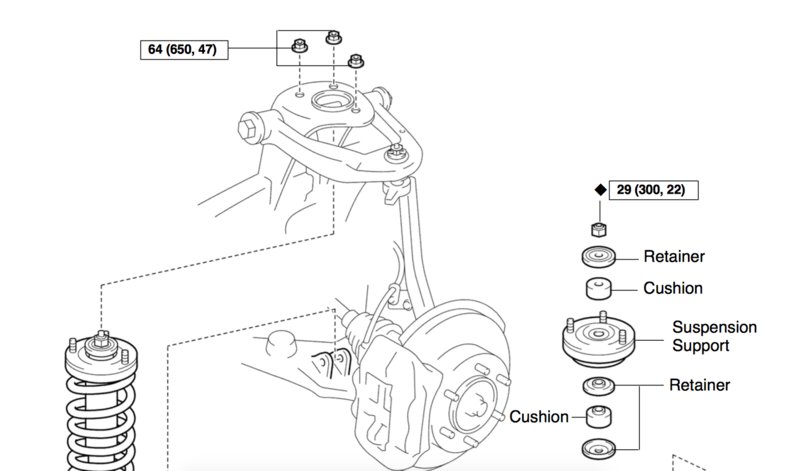

    also anyone know the torque specs for the bottom bolt connecting the shock to the LCA and the 3 top bolts on top of the coil bucket? I looked in the FSM but couldn't navigate it very easily the labeling for the folders in the downloaded one were so odd

    105 or 115 for the bottom bolt IIRC and 27 for the top hat bolts IIRC.

    looked around a bit and found 101 for the bottoms but ill do 105 for it, top bolts ill do 27, thanks
    EDIT:
    Just found the top bolts,
