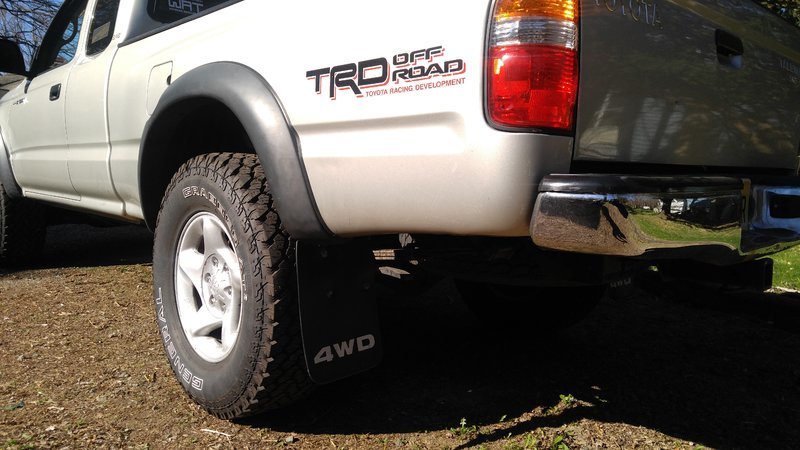

    Got the rear flaps on. For the broken bolts, we ended up drilling them out and then retapping with a slightly larger size. All things considered, it went fairly well.
