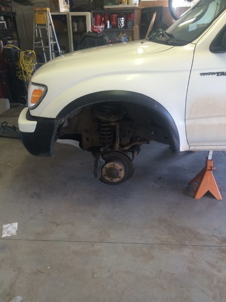

    So it begins... Can't be too hard can it... Putting on kings
    jubei, Burnett and Deathbysnusnu like this.
  6. Apr 21, 2016 at 5:42 PM
    Deathbysnusnu
    Deathbysnusnu Work is just a daily detour to happy hour.
    Oct 4, 2013
    #113825
    17,299
    Brett
    Fort Crawlins, CO
    Vintage Tundra
    Dog, camper.
    very easy for the front. As long as your old hardware come out, should be a breeze.

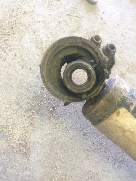

    Who needs bushings anyway.... Sooo my kings are set to tall it fit... Sway bar or uca?
  9. Apr 21, 2016 at 5:58 PM
    Deathbysnusnu
    Oct 4, 2013
    #113825
    17,299
    Brett
    Fort Crawlins, CO
    Vintage Tundra
    Dog, camper.
    them are still good. ;)
    Get a long pry bar and pull down on the uca. You might need a friend to help. In my case I have no friends and used a sandbag on the end of a 7' bar.
    It will also help a great deal to remove the swaybar. Might as well do it now as you will most likely do it anyway.
    BYJOSHCOOK, ebbs15 and Silver02Taco like this.
  10. Apr 21, 2016 at 5:59 PM
    Deathbysnusnu
    Oct 4, 2013
    #113825
    17,299
    Brett
    Fort Crawlins, CO
    Vintage Tundra
    Dog, camper.
    you'll gain 1" of lift with a new bushing alone.
  11. Apr 21, 2016 at 6:03 PM
    JKO1998
    JKO1998 Well-Known Member
    Jun 2, 2015
    #156578
    53,074
    Utah
    Sad huh... I might have to wait for my dad to get home to finish this, not a huge deal. I think my kings are set to 3ish soo they'll need to come down a little haha
  12. Apr 21, 2016 at 6:05 PM
    Deathbysnusnu
    Oct 4, 2013
    #113825
    17,299
    Brett
    Fort Crawlins, CO
    Vintage Tundra
    Dog, camper.
    it won't matter where the coil collar is set, the shock will still be the same length.
    They are lifted and therefore a bit longer than stock, so it's normal to have to pry down on the UCA to get the LCA to drop far enough to get that bottom bolt in.

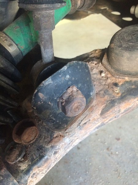

    Just this bolt on this side I guess huh
  16. Apr 21, 2016 at 6:17 PM
    Deathbysnusnu
    Oct 4, 2013
    #113825
    17,299
    Brett
    Fort Crawlins, CO
    Vintage Tundra
    Dog, camper.
    yes. In the center of the stud you have pictured, if you clean out the mud, you will see a hex for an allen wrench.
    You will need to allen wrench to hold the stud while you loosen the nut.
    Spray it first with something oily.
