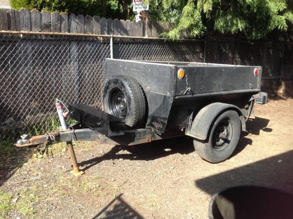

    think i could make a rtt trailer out of this?
    not looking to do anything crazy, but do want to take it over discovery routes etc. not a big crawler but will crawl to get somewhere
    owner doesn't know anything about the axle, but it seems even when people buy m416's they end up swapping the axle anyhow?

    Looks pretty sturdy to me. Why not? You will most likely be changing just about everything during the build.

    thats what i am noticing as i browse builds, seems everyone changes just about everything under the frame, so why spend so much 800-1000 on a m416 if the only thing you are keeping really is the tub & frame?

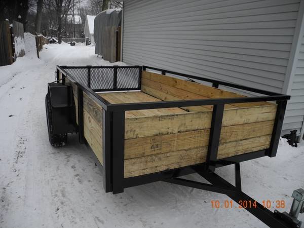

    I build lots of trailers so those tag along trailer builds really interest me. You are correct in starting with something cheap. Just the tires wheels and steel will cost you near $1000.
    I like to build these:

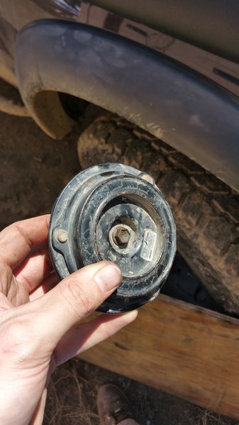

    First pulled this off, it's either a 10mm or 12mm bolt. Had to wedge a screw driver against one of the studs to keep it from turning.

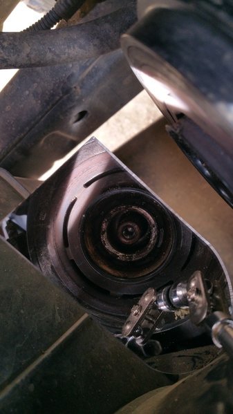

    Here's what it looks like without the cover.

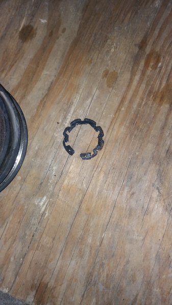

    Goofy looking snap ring if you ask me.

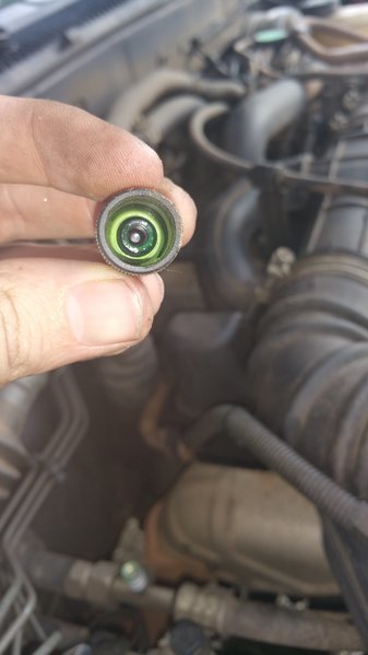

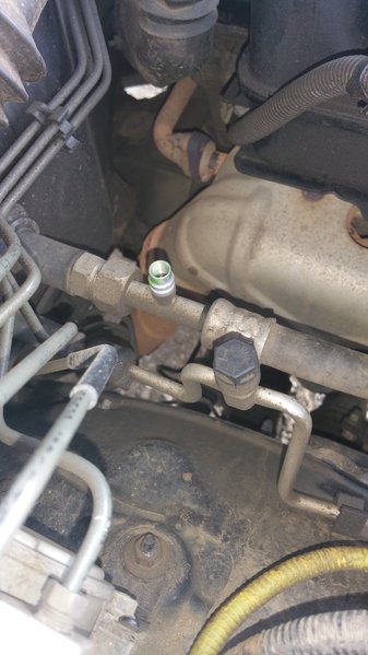

    Now that my bearing is good my ac only blows hot air. It kind of worked before I pulled everything apart but wasn't ice cold. I plan on recharging it and hoping for the best. I noticed some freon on the cap but I'm guessing it's just leftover from the last time it was filled.
    Anything else I should check before I refill it?

    You need to vacuum the system to remove the moisture in the air that's in your lines first, that's why it only sorta worked. Should also replace the receiver dryer canister before you vacuum and recharge.

    Yea it's defiantly do able. Just starting mine also an it's defiantly gonna be a project.
    Mine may be a bit rougher than that though.. Good luck !

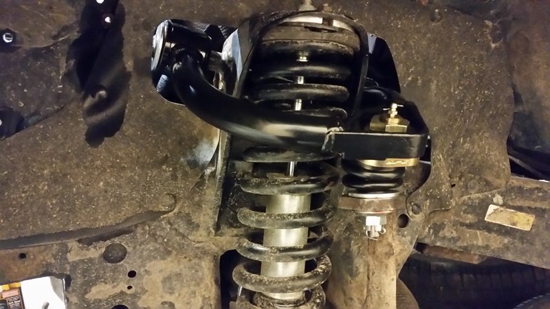

    New SPC UCA installed, got the Toyo sticker wore of the new tread and the rattle can wheels out in the sun.
    Time to complete...
    Passenger side: too long!
    Driver side: 1 hour, that includes battery and collision sensor removal.

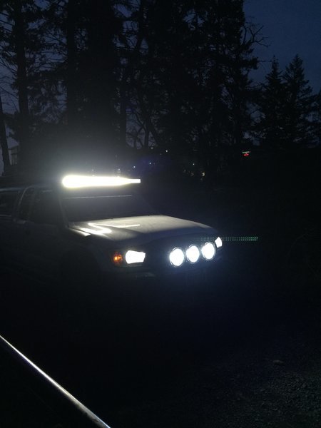

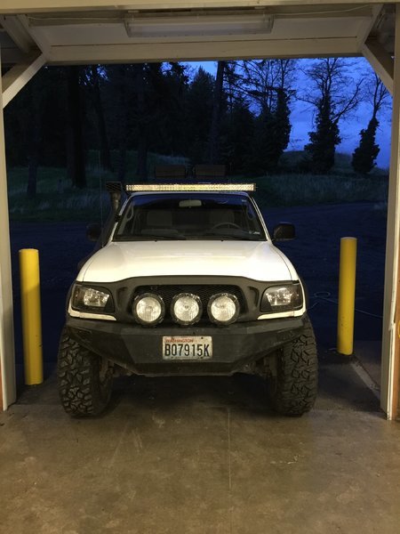

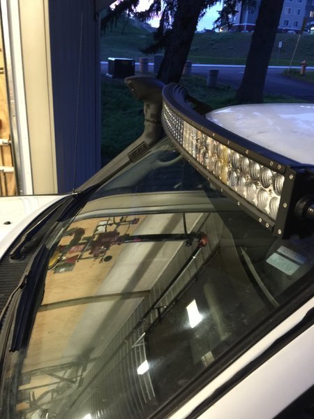

    Replaced my stupid strap on roof rail light bar system with a curved 50" and legit mounts.
    20160423_030357186_iOS.jpg 20160423_030427782_iOS.jpg 20160423_030747509_iOS.jpg

    do what? the UCA's? the worst part is getting the ball joints out, after that its all real easy. getting my old shocks and coils off was harder than those. I didn't have to remove the battery, didn't think you had to

    Is that an actual grease zerk in that uca? I wonder when they started doing that...
