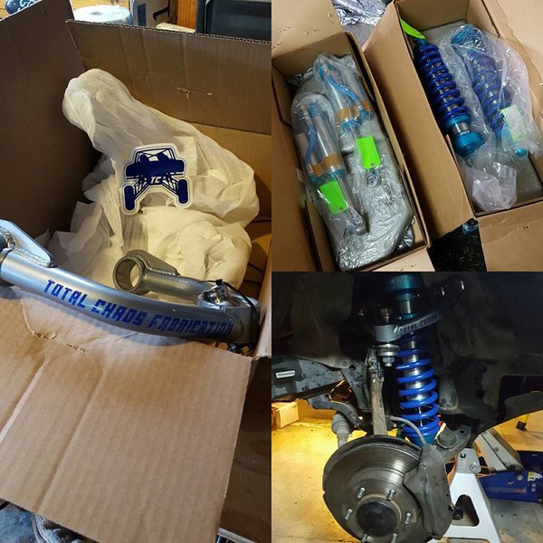

    I only removed the battery for better access to the collision sensor bolts. The collision sensor is in the way of the long bolt that passes through both end of the UCA. The bolt only slides out a couple of inches before hitting the sensor.

    I didn't know spc started putting grease zerks on their uppers. Nice.

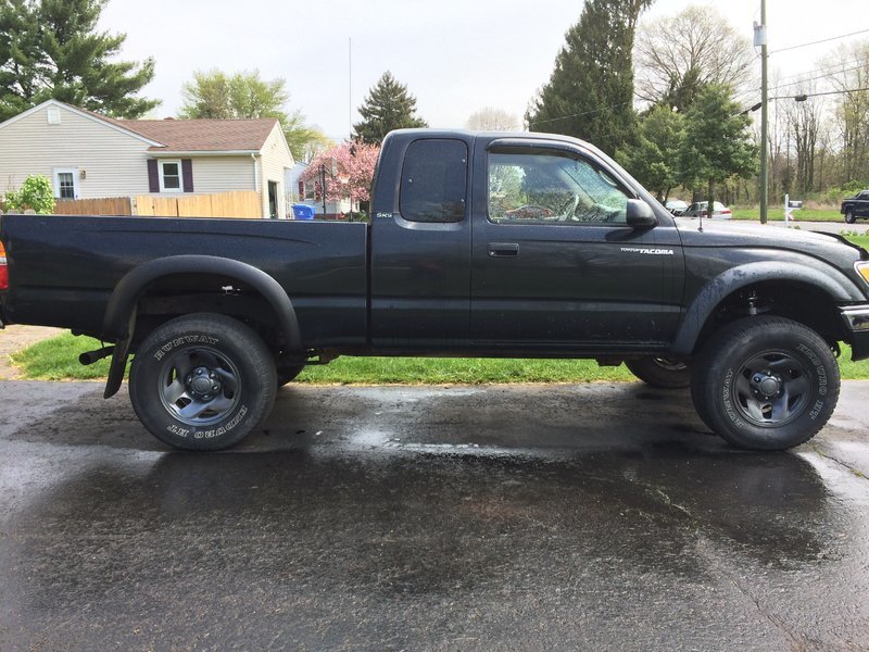

    I'm on 265s right now but I plan on getting 285s in a couple months here's what 265/70s with an OME lift looks like:
    They aren't as small and weird looking as I was expecting them to be but if I was getting new tires id go with 285s

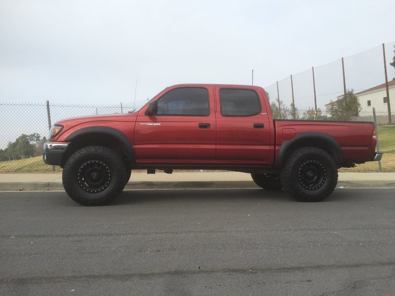

    285s all the way. Was in the same boat as you when deciding to buy tires but the truck is only gonna get taller...
    285/75r16 with bilsteins 5100 in the frontimage.jpg
    Raiderjaden and Soflanick like this.

    No rubbing?

    Small amount of rubbing on the plastic fender stuff but with a dremel I cut most of it out an doesn't rub now.
    Wheel does rub a tiny bit on the frame when fully turned but that's because wheel offset/backspacing I believe
