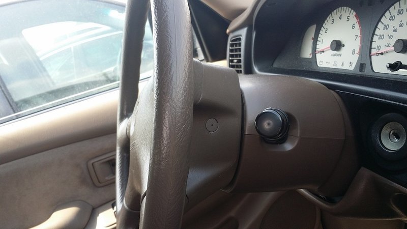

    Yeah, I see this, we will see what happens...

    That little round knockout is for access to a torx-head bolt. There is one on each side. That's how you remove the horn-pad/airbag assembly (the first step).
