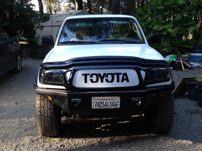

    image.jpg Finished and mounted!

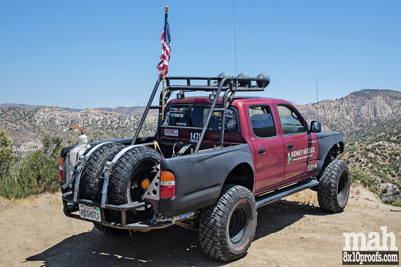

    Engage Offroad long travel front and rear with some fat tires.

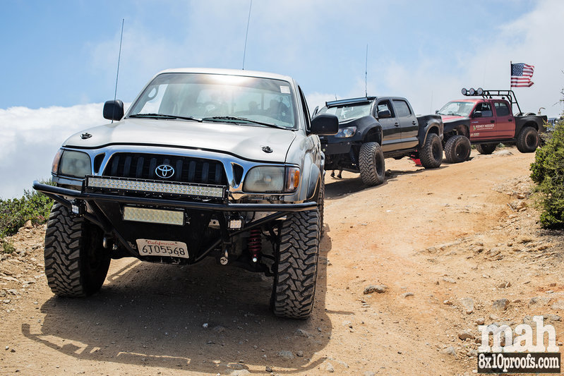

    Took my baby out into the dirt for the first time in 2 years since getting sick. So grateful to my TW brethren who got me out there with my baby.

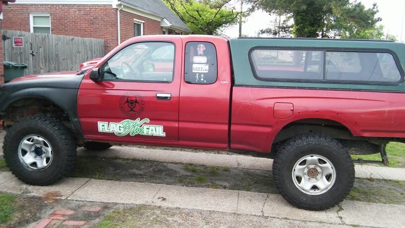

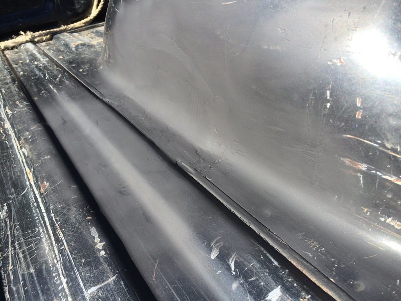

    Got the bed all finished up and on the truck, Gotta sand it down more because I threw some bondo on there last minute to smooth it all out a bit but overall better than a big rust hole :D

    I've got a rust hole on mine and at some point, I want to address it. Bondo was my first thought. What else did you do? Yours looks good.

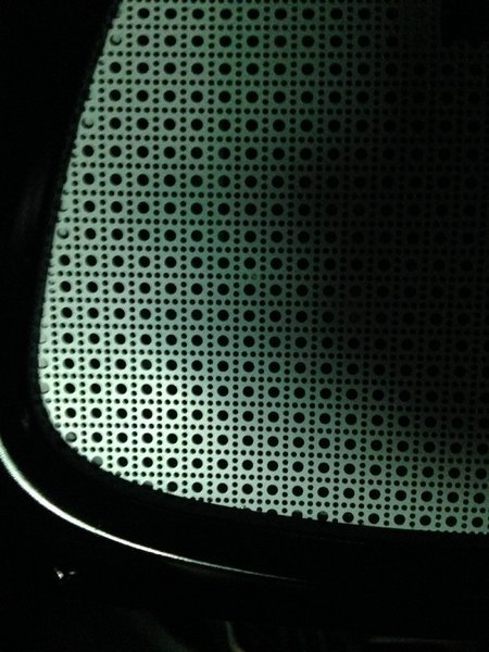

    how dense is that mesh? do you think you are limiting air flow to the radiator

    It lets a lot of air through, but I'm sure not as much as the stock one did.
    It looks much denser in the photo than it does in person, that white is just really bright.

    image.jpg It's a bit dark, but this is a closer picture of the mesh.

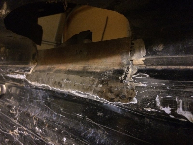

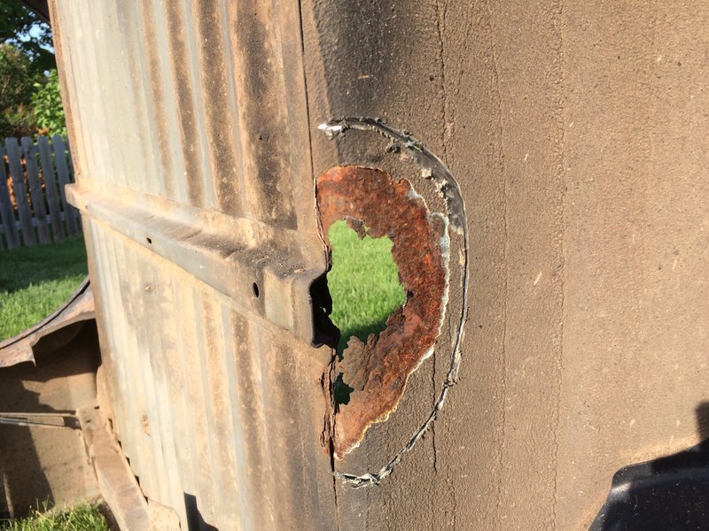

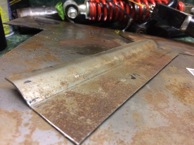

    Thanks man, basically just cut out the areas and anywhere the rust even touched,
    Then I made some replacement pieces out of 16awg steel, it was kinda thick compared to the bed steel but seemed to work alright. Bent it between 2 pieces of thick steel tubing in a vice to keep it nice and straight and even, just used a hammer no heat or anything necessary. only have a pic of one of the pieces which went over half of one of those ridges:
    Weld everything in on low current settings, I blew holes through the steel but eventually got used to it, just can't run beads Gotta tack it one after the other (only part of it in no pics of the other piece):

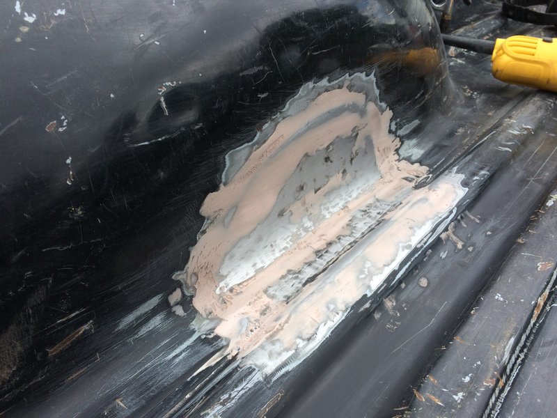

    Then basically grind it all down and throw a bit of bondo on top to fill imperfections and tiny holes between tacks (maybe it's just me and my bad welding, i dont know):
    Sand prime and paint

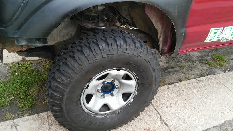

    Just some new tires and fender trim. :eek:
