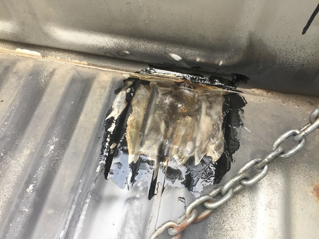

    Really simple, can probaby find a how to online but the short version is:
    1. Mix Resin with hardener
    2. Coat body panels with mix via brush
    3. Coat fiberglass sheet with mix via brush (preferably on a piece of carboard since it's messy)
    4. Place wet sheet on hole
    5. Brush mix on sheet/edges again
    6. Drink beer and let dry
    It's messy but very stiff and durable when dry. That's how I have always done it, plenty of guides online about fiberglass work. It's not pretty when done raw like this but it's covered by a bed mat or liner anyway.

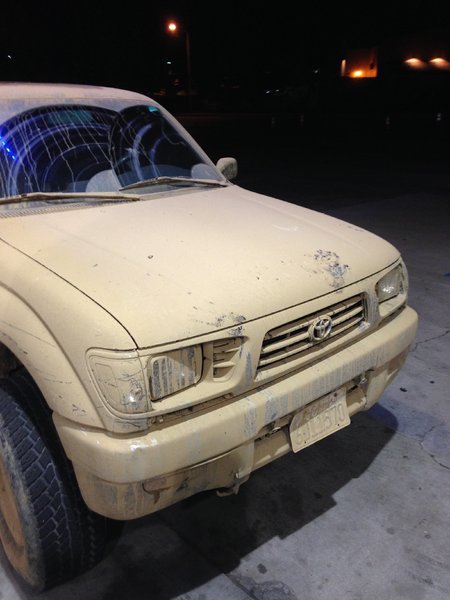

    I think thats just how they look. It's like that on both sides. This is another picture from the same night.

    looks normal to me. besides the missing headlight fillers...

    Those are some questionable hand prints on the hood. Did you happen to get "stuck".

    What do the headlight fillers look like?

    ahh, must have been the angle...

    the missing panels under the headlights..

    Haha extremely. Didn't get out until after the sunset. Our only strap broke :(
