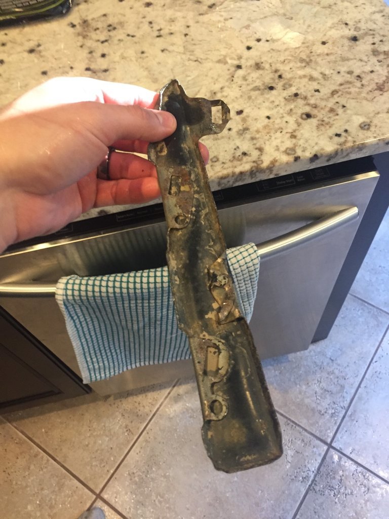

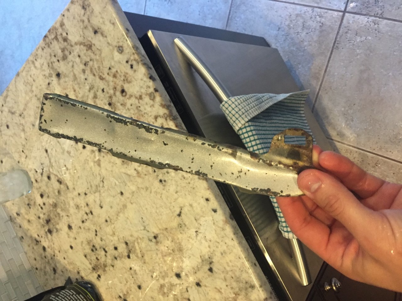

    No I know it is yours haha I'm just saying those things fall off all the time on our trucks I've ran over like 3 of mine already
