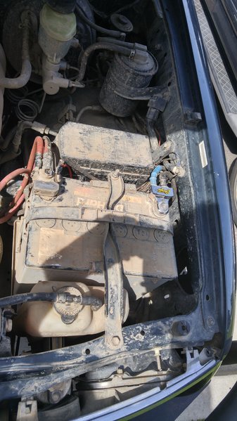

    I like my xscorpion positive one and my stinger ground. These only take ring terminals though.

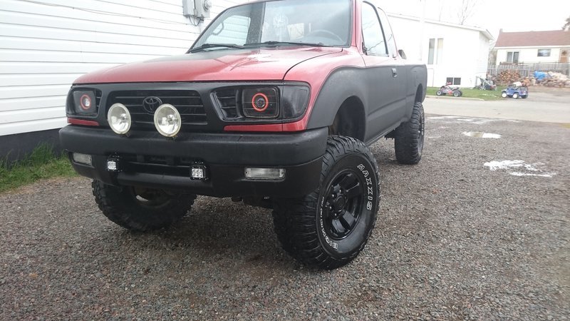

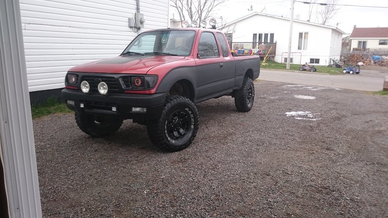

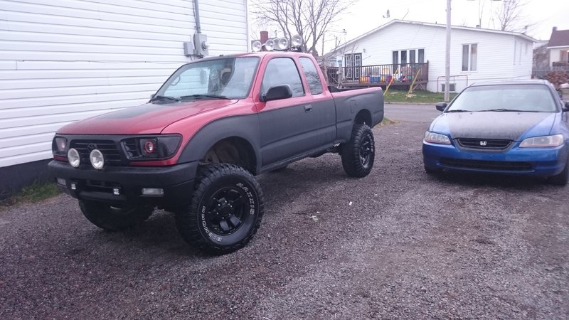

    Fresh paint on them.

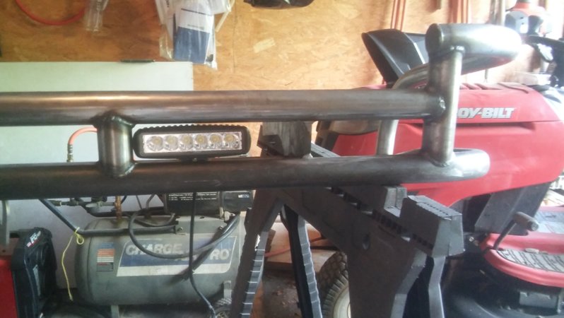

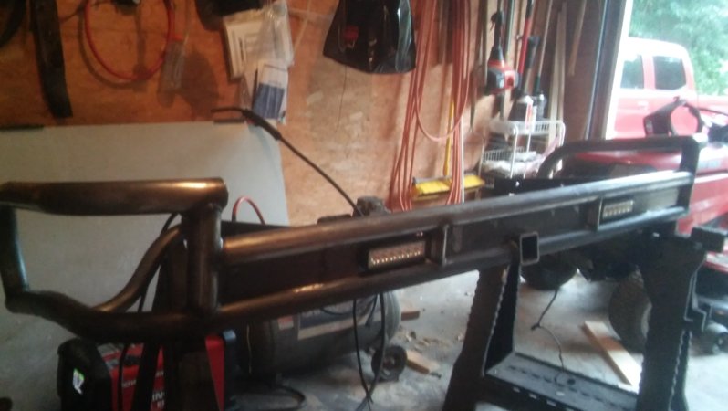

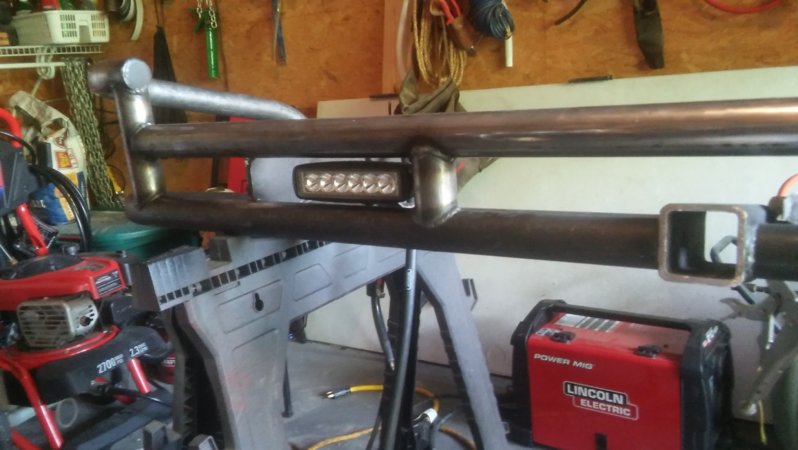

    Got my backup lights mounted
    and install some fill panels between the pipes.

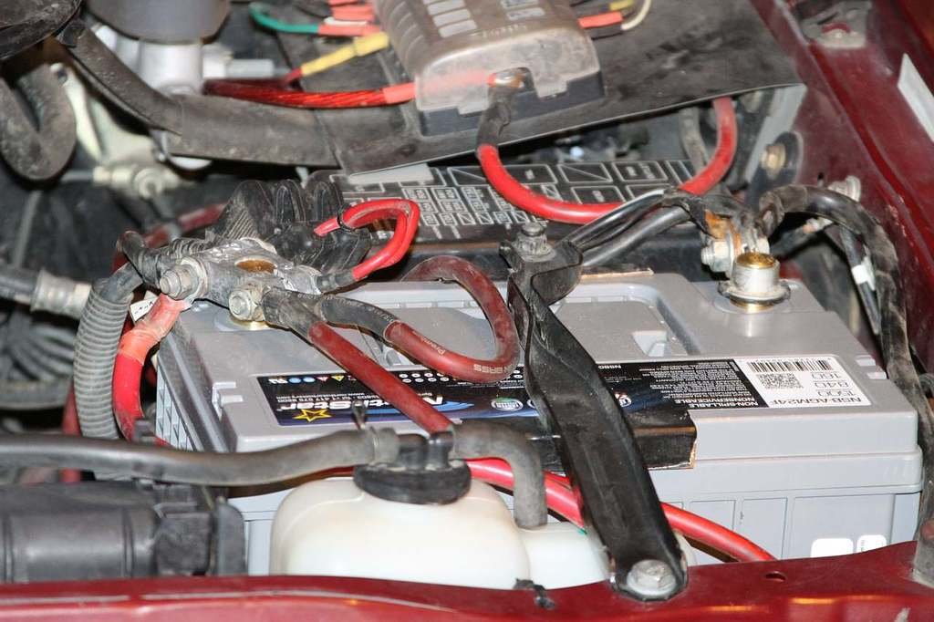

    My preference is military style clamps like these.
    http://www.amazon.com/Fastronix-Military-Connectors-Positive-Terminal/dp/B005260K2A
    Note they come side specific because battery posts have slightly different diameters. IIRC, the positive (+) is slightly larger than the negative.

    I like these. My question would be how would they be with hooking up power leads for my amp and future lighting I want to add.

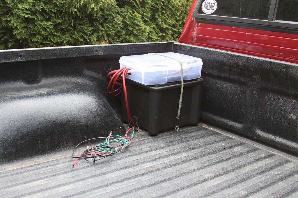

    That is one of their advantages. I've run my amps, compressor and winch leads off of them.
    This an old pic. I've since gone to a dual battery setup and moved some of the items you see hooked up here, to the 2nd battery.

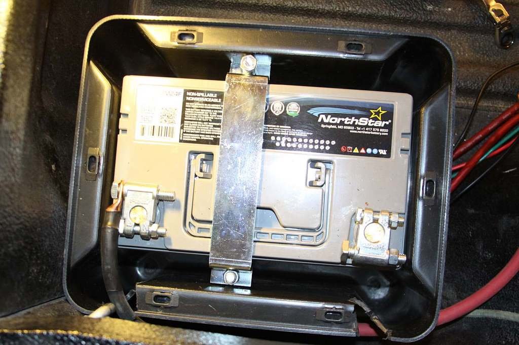

    2nd battery in the bed.
