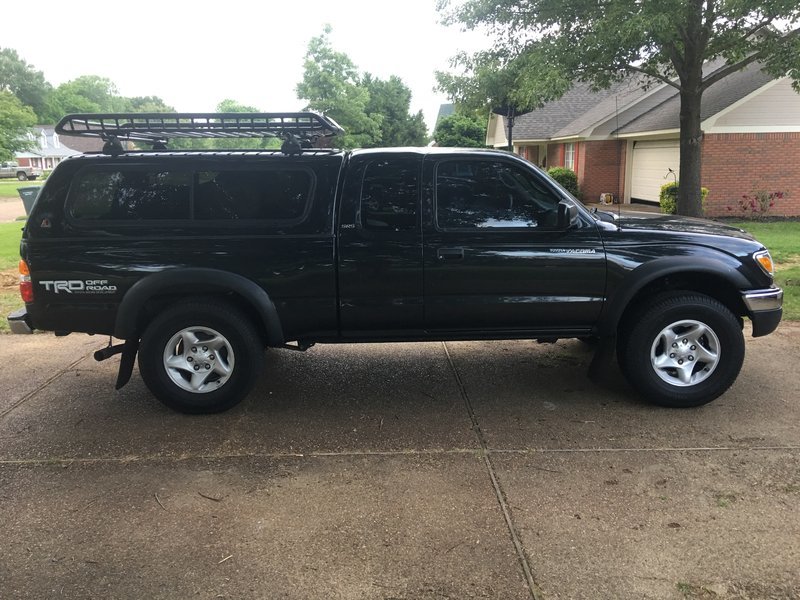

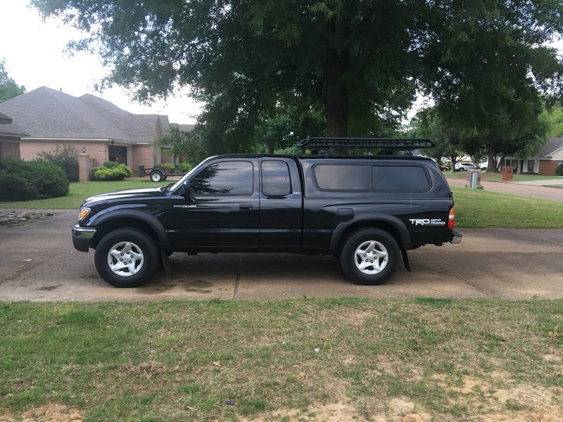

    New TRD decals. Truck is squatting because bed is loaded with 800+ lbs

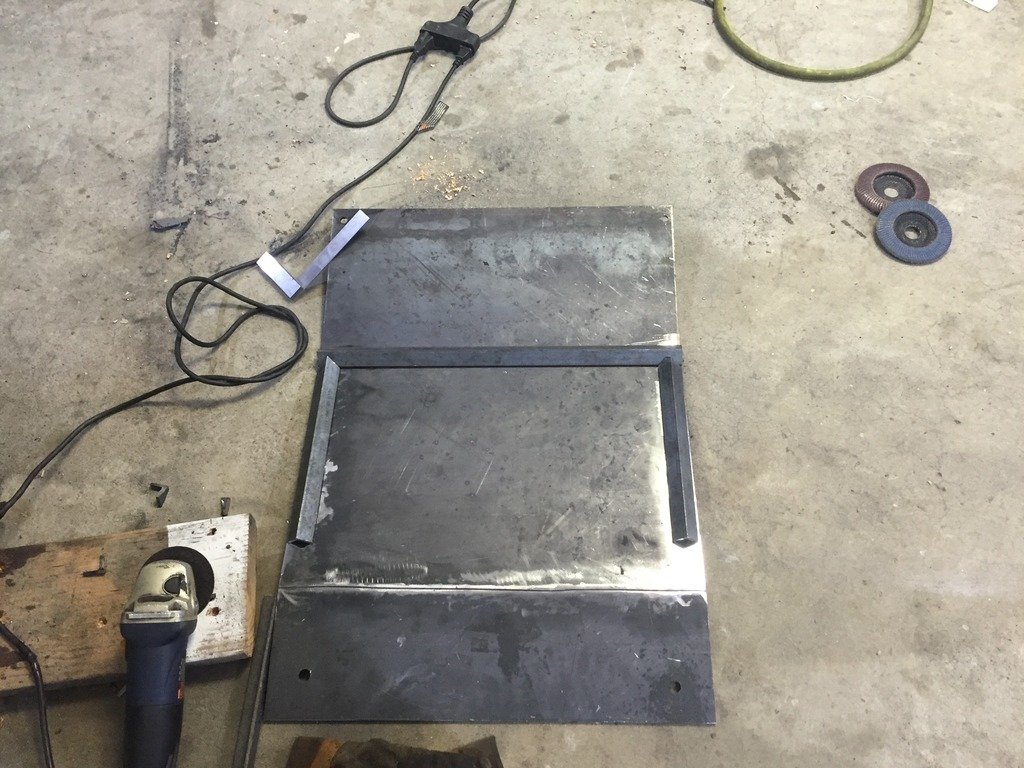

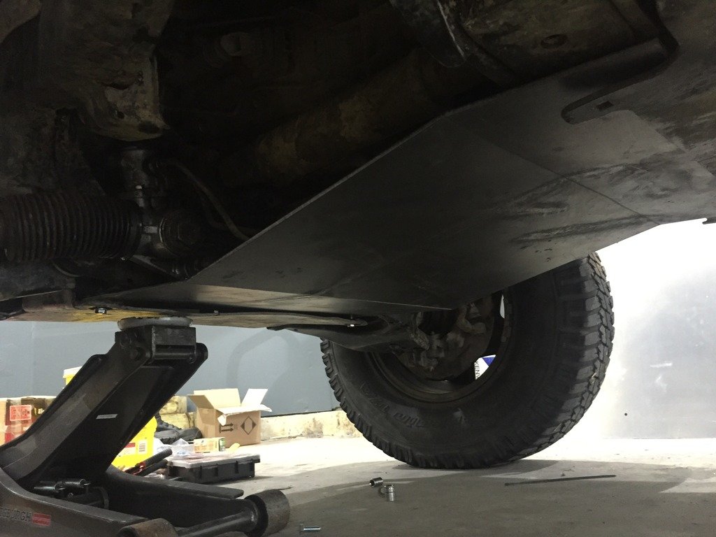

    More work on the trans skid since I am getting together with my buddy who has a welder next week.
    Only boxing the center section really. Don't need to go nuts on this skid.

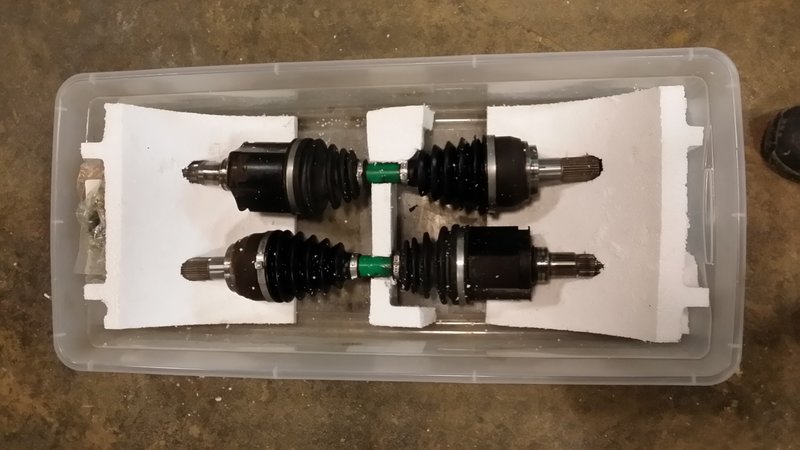

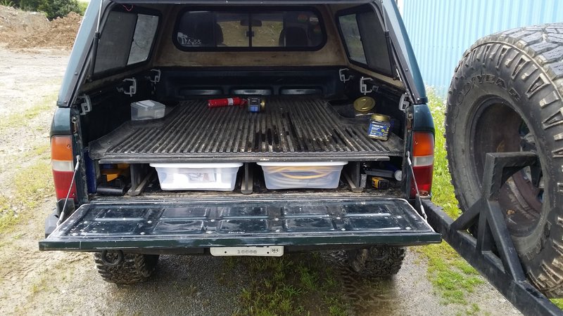

    I got tired of my spare axles banging around so I grabbed some Styrofoam and nested them into these waterproof containers.

    Two trail spares? Not likely you'll need more than one, since left and right are interchangeable.

    Better to have and not need than need and not have? Especially if your buddy needs a CV. Or you were locked up front and grenaded both at the same time.

    Not that anyone has done that recently...:spy: Most spares= more fun. With the way mine eats CVs iv been using the reman autozone ones and warranteeing them out.
    The awesome part about the ADD diff is that when a CV blows it's almost always the outer bearing cage. So you turn the wheel at full lock one way pop the boots off the outers. Turn the other way and remove the shaft from the outers and your good to drive home.

    These are my originals. I had torn boots a couple years ago, before I discovered TW, and just replaced them. Now I have 2 rebuilt factory axles. Nothing wrong with that.

    I suspect those axles will end up tearing up that styrofoam. I did something similar and after all the jostling around from the trail, I ended up with styro-peanuts. :rofl:

    Closed cell foam is a great material for this sorta thing too. I always save it when I buy electronics. Great stuff, just really expensive to buy separate.
