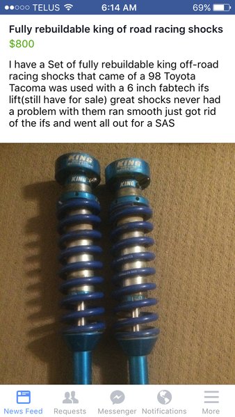

    the fabtec uses longer struts instead of a spacers unless he added some.

    Those will only work if you have a drop bracket lift, or change out the lower mount.
    The one's for trucks without a DB lift run $1,000 USD new.
    Pass.

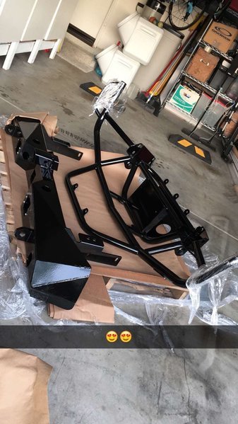

    Got these back from powder coat today.. Front is a all pro baja an the back is a relentless WIYimage.jpg
