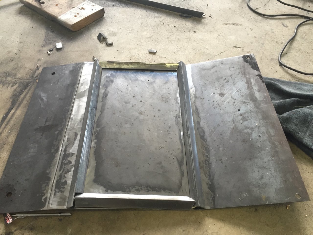

    Drop bracket lift and booger welds
    Finished setting up the boxing of the transmission skid:
    And have most of my switch setups figured out for the tool box. Now to take it all apart to paint the paranoid switch panel.

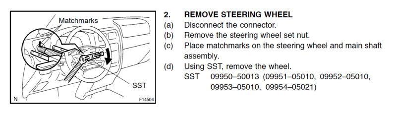

    OK, so I am trying to remove the aftermarket CC and put in OEM CC. I have a used wheel, with the CC stalk and connector.
    I removed my hornpad, then I removed the nut holding the wheel on.
    I couldnt get the steering wheel off.
    I couldnt budge it. Was I missing something, or is it just so tight on those splines?
    I was whacking it from the backside at different angles, then trying to pull off but no joy. I obviously didnt go apeshit on it.
    What is the technique for removing the steering wheel?

    I think you have to use a steering wheel puller. Might be able to rent one from an auto parts store.

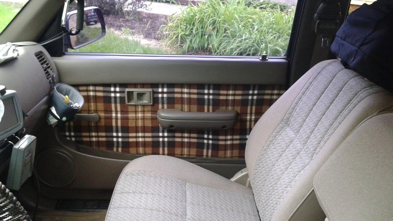

    Stuff and things that make it better.

    this I like! is it a fairly simple job? how did you fasten it?

    If you take door panel off youl see everything comes off with phillips head screws from the backside.
