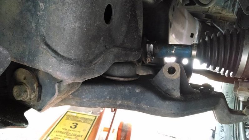

    do you have tc uca's? Mine have been squeaking real bad lately too, gonna throw more superlube on the bushings soon, been putting it off

    I have TC but not installed haha. But after I sprayed some WD-40 it went away for now. I'll check tomorrow.

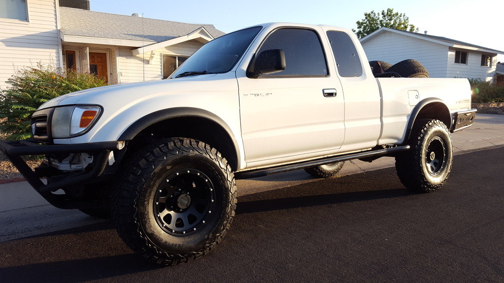

    Alright guys ready for the most commonly asked question on here?
    I just need to beat back my wheel well and pinch weld and maybe do a timy bit of trimming to fit 33's at full bump/lock right?

    do you have stock wheels? if so then I think you will need wheel spacers to not rub the frame at full lock or wheels with proper backspacing. might just be with 285s though, Ive seen that skinnier tires can clear fine. Also might rub your UCA if its stock, mine is VERY close with my total chaos UCAs
    just reread didn't see you said "stock" :oops:

    depends on width and backspacing. 12.5s need a little finessing to be completely rub free and are known to rub the washer fluid reservoir.

    285 75 16 bfg ko2s

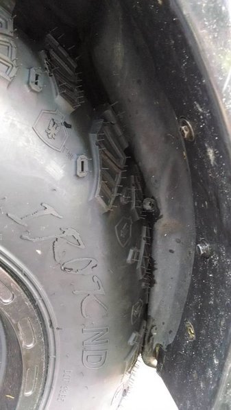

    Theyre on and they rub a little when i turn and hit a bump. Going to work on it tomorrow.

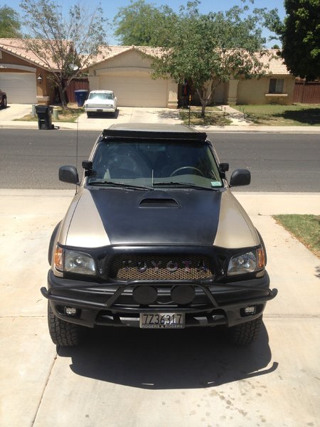

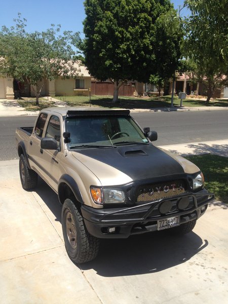

    Ok you CB experts, what's the best location to mount an antenna, center of the bed or side? I've seen conflicting info on it.

    roof, then hood. everywhere else sucks.

    x2 Hood is a little easier to do than the roof tho. Ground plane, ground plane, ground plane.

    My whip works awesome. But then again it's a 102" whip..

    Maybe, to do it right, you need to pull the coil over and set the truck down gently on the bumpstop, then cycle the steering if you can and see what rubs.

    I dont have the tools to do that unfortunately. I was thinking i would trim the stuff thats obviously rubbing and smash it back then put some chalk inside the wheel wells and flex it out then see where the wheels rub the chalk off

    You'll prolly be fine that way. Take the tire off at least so you can get a good whack at it with the bfh.

    That much i can do.

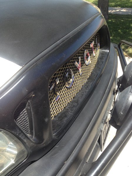

    So are 01-04 headlights adjustable...as in the aim of the light beam?

    Yes, up and down. Not side to side.

    Okay is there just screws in the back somewhere? Ill have to look at them in the morning! Thanks!

    Yes, the adjuster requires a 4 or 5 mm socket.
