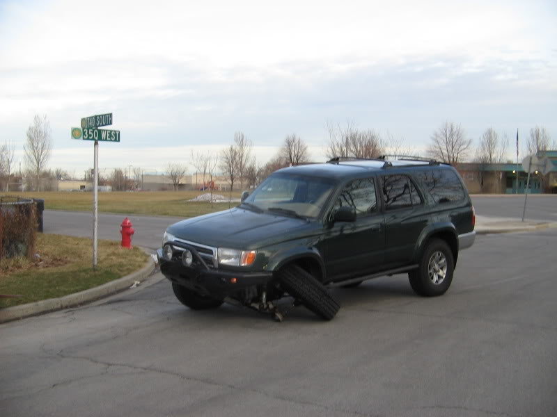

    Can you verifiy all of these were moog joints that broke?
    thumper72 likes this.

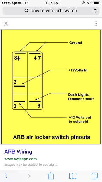

    @Blackdawg or anyone else that's connected an ARB compressor Please help.
    Im trying to get my ARB compressor connected and there is a red and yellow in the loom that is suppose to connect to a 12v supply and the directions say connect it to a lighter wire. Which I think I found. Im connecting it to the red wire from the three wires on the lighter wires. Good or not good?
    But this is where Im really lost. There is a blue and white wire also, that I need to connect to a dash light. OK WTF! how can I find a correct dash light. any advice on where to connect the blue and white wire would be great!
    Thanks!

    Don't use the dash light one. Connect the power to a fused source straight from the battery. I wouldn't do the cig lighter unless you are taking about the switch?

    You only hook up the dash light dimmer of you want a light on when you turn on the headlights . I didn't want that.

    It's for the switch.

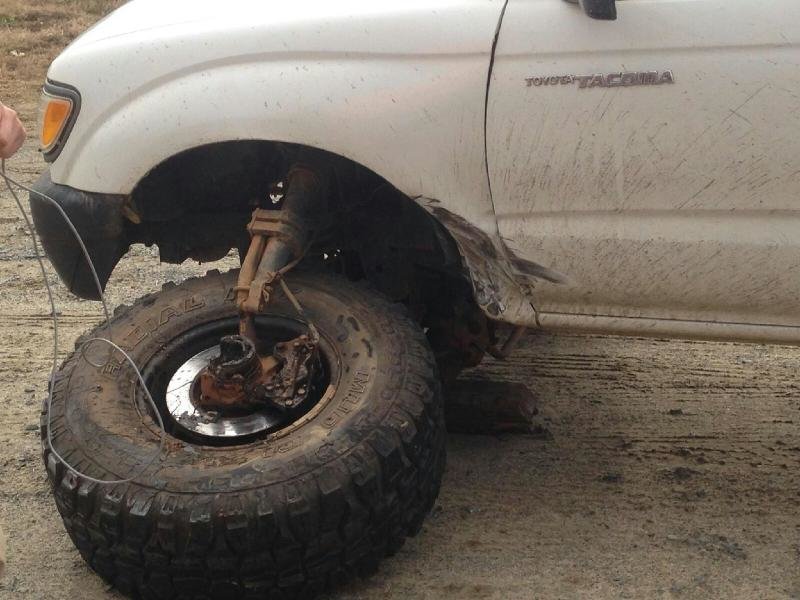

    Looks like bolts came out on that bottom one. Im always checking mine in fear ahaha

    No I can not, I am not saying they were, just showing what happens when any of them break or bolts come out.
    If this is the result then why would you use anything but what is considered the best? :notsure:
  18. May 28, 2016 at 1:45 PM
    JBTacoma
    JBTacoma Well-Known Member
    Feb 16, 2015
    #148844
    11,118
    Jeff
    Cullman Alabama
    2000 SR5, 2003 Double Cab and a Suzuki Samurai
    Yes they were, but Toyota tried to correct the problem, MOOG just keeps selling theirs.
    Just trying to help, not trying to defend Toyota, just putting the info out there, if you still think there are better parts then OEM I wish you nothing but the best of luck.
