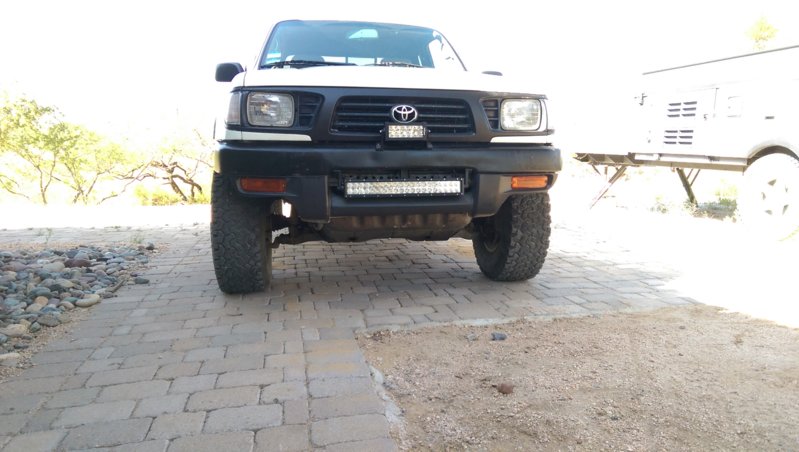

    I smashed my front bumper while driving through a wash, which left me with some tire rubbing on my bumper. Fixed it up with some trimming. Should hold me off until I order a tube bumperupload_2016-5-28_16-17-24.jpg

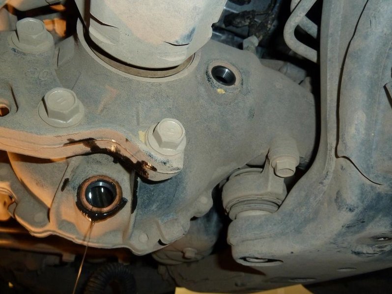

    Guys where is the fill plug on the front diff? Have a 5vz. I can't for the life of me find it!

    Right in the front in the right hand side I believe...big Allen key

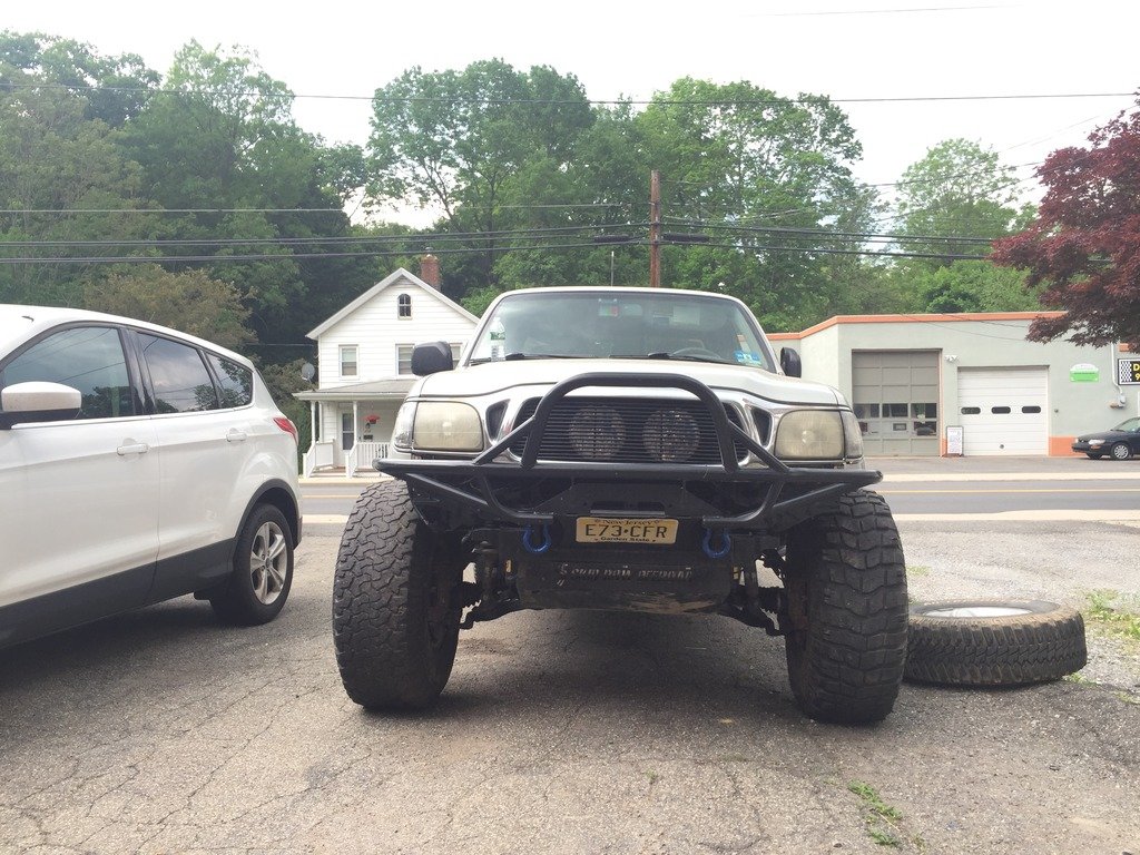

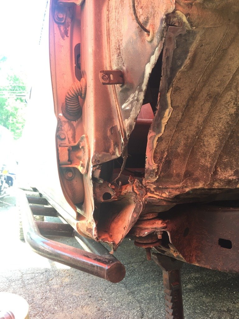

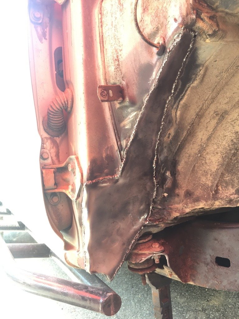

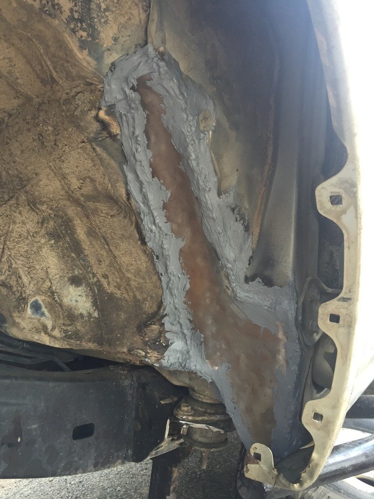

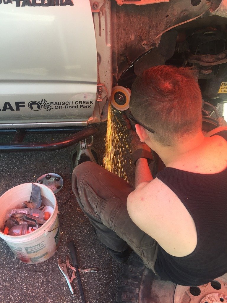

    Drop bracket lift and booger welds
    Finished the other side today. We figure for the actual cutting/welding/fender removal were about 4 hours per side, and about 14 hours total for both sides, seam sealer and re-assembly. Now that the hard part is done I can trim the fenders whenever I have time.
    And for shits and gigs we threw on whatever 35's we had for testing to see what it would look like. Keep in mind we tested with spacers on with 4" bs wheels so looking at 2.75" bs when I will run 3.75" bs. It's pretty fucking beastly looking.

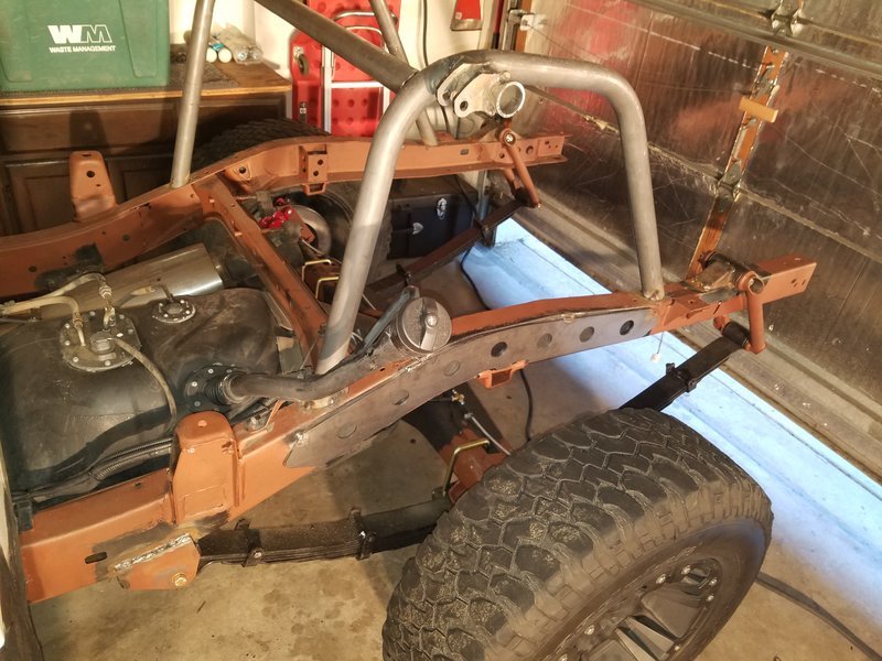

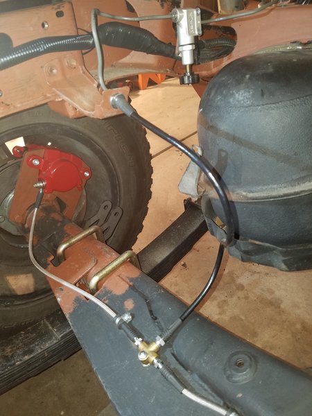

    Because pics are always fun. Love my first generation brothers.

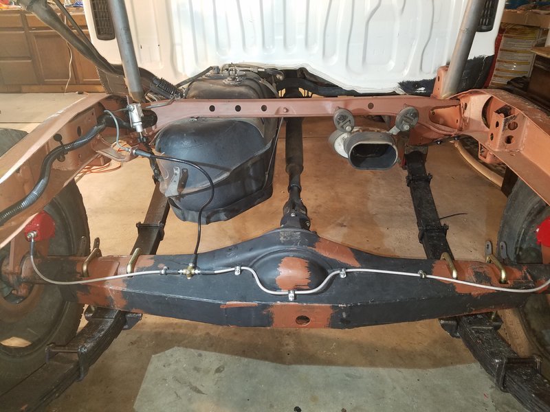

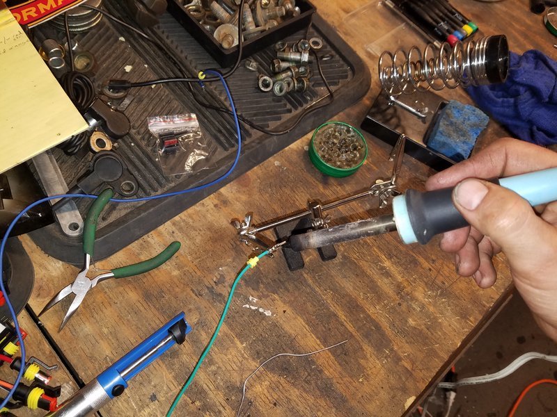

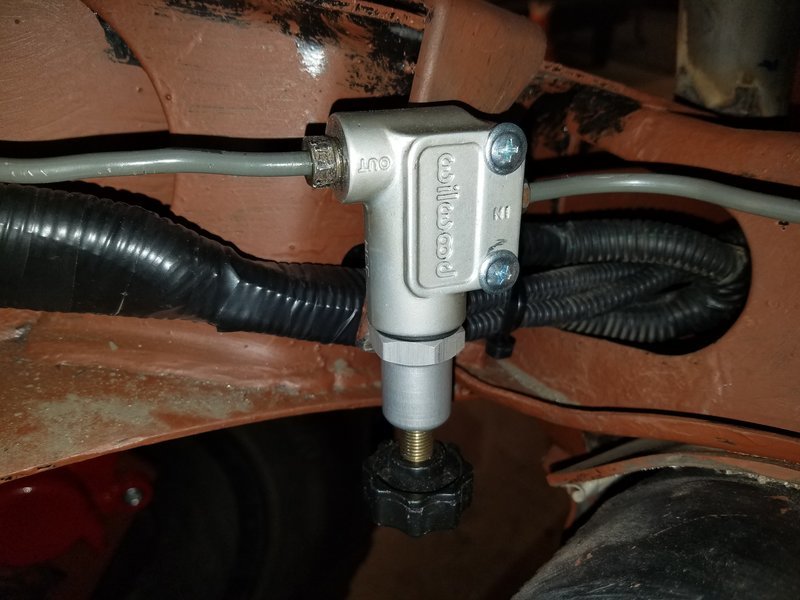

    Today I completely removed the e brake from middle cab half back. Rerouted a bunch of brake lines to accommodate for the bpv. Installed the bpv. Plummed all the brakes. Just need to bleed them. Also redid the electrical from cab half back. All rear end lighting. Trailer lights too. Not like I'm set up to tow a lot now but maybe something small. Not sure if a taco was really meant to tow in the first place. Soldering is tedious. I used waterproof connectors which I absolutely love. I'm starting to see the end.

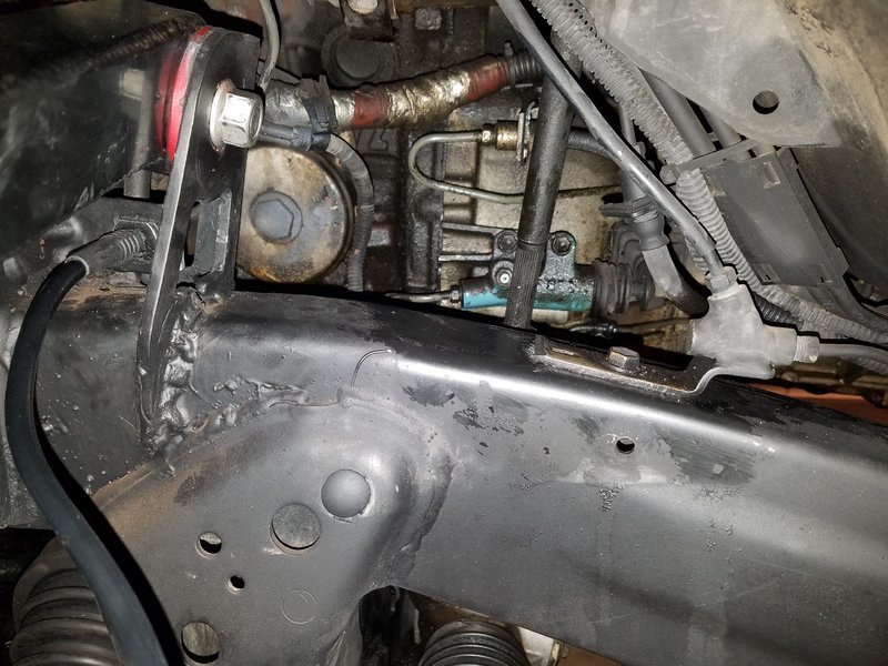

    Cut off an entire 3 way here that was part ofthe brake system.

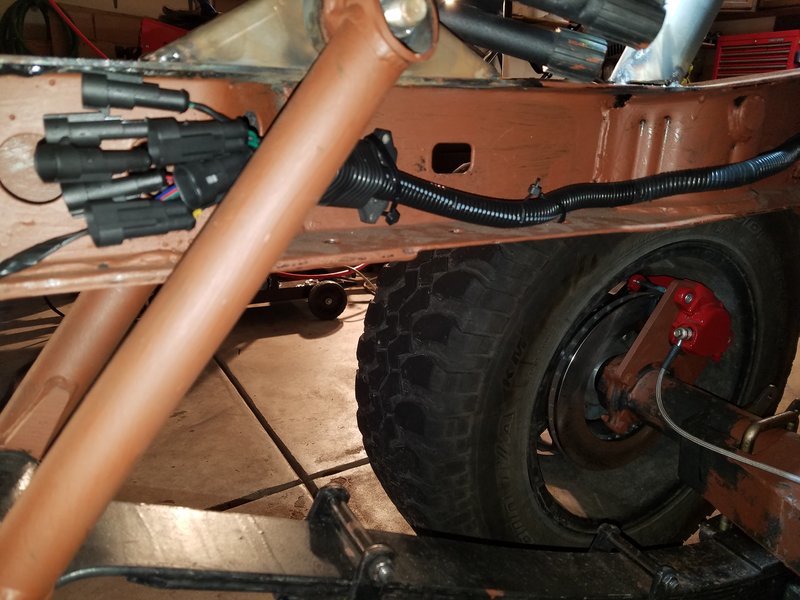

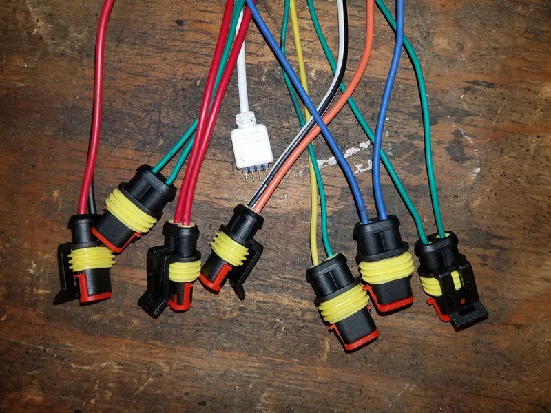

    These yellow plugs push inward creating awaterproof seal.
    What all the plugs will go into. Connects to rear end electrical on the bed and hitch/trailer.

    Man. I shoulda done 315s. So much easier looking, your hole is tiny.
    Yea most likely won't work. Can try..but Id be amazed if it did.

    Figured it out. It was cake with oil and grease I couldnt see it lol

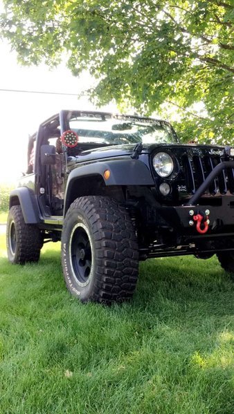

    Did a bit of night wheelin can't say I enjoy getting home at 3am though :p
    Also helped my friend throw his bumper and lights on his jeep (wish I had these kinds of funds)

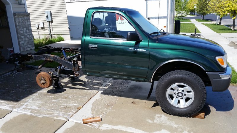

    how much did it take to do the frame? of that corroseal? been looking for something like this to do mine since its decently clean but has a little rust in area and would like to protect it while i can before winter again in utah.
