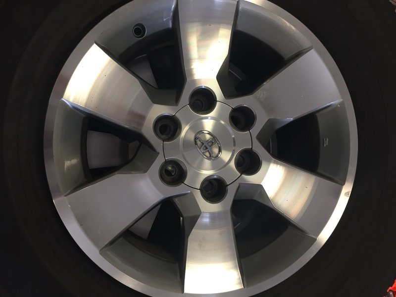

  14. May 29, 2016 at 8:13 AM
    thumper72
    thumper72 Well-Known Member
    Jan 26, 2016
    #176144
    370
    Jon
    Ogden Utah
    2000 toyota tacoma prerunner v6 auto
    5100's, ome dakar leafs and ome coils, problem solver tie rods, eazycompany ditch light brackets and auxbeam osram 4" led pods, 2014 4runner wheels, 265/70/17 goodyear authority tires, soon to have 50" led bar on roof
    IMG_20160519_192802_01.jpgfrom a 2014 4runner with same specs I guess for wheels as my 15"s just it's a 17" wheel Is all
  15. May 29, 2016 at 8:17 AM
    retroboy1989
    retroboy1989 Single Cab 4x4
    Apr 8, 2016
    #183693
    738
    99 2.7L 5spd 4x4
    It was my understanding that late model toyota wheels had more bs than 4.5". I can confirm your stock wheels have 4.5"

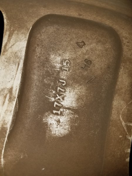

  16. May 29, 2016 at 8:24 AM
    retroboy1989
    Apr 8, 2016
    #183693
    738
    99 2.7L 5spd 4x4
    Look for the 17x7 stamp on your wheels. There should also be an offset number.
    thumper72 likes this.
  17. May 29, 2016 at 8:25 AM
    thumper72
    Jan 26, 2016
    #176144
    370
    Jon
    Ogden Utah
    My new to me wheel specs....
    15
  18. May 29, 2016 at 8:29 AM
    retroboy1989
    Apr 8, 2016
    #183693
    738
    99 2.7L 5spd 4x4
    I stand corrected, same offset and bs as the 15x7 split 3 spoke wheel
