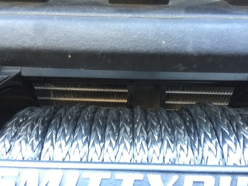

    Got my winch installed, but I can't spool it all the way in- the stupid hood latch support is in the way. I've still got about 20' of rope left. Is this something I can do without? I'd like to just cut it at the top below the bottom of the latch bracket and undo the bottom bolt.

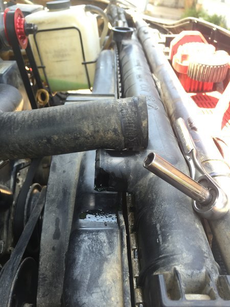

    This is my spare 20" rad. The damn bolt is stuck in
  16. May 29, 2016 at 1:55 PM
    nagorb
    nagorb Should be a dang perma mod
    Feb 28, 2011
    #52025
    9,352
    Alabama
    2001 dbl cab 4x4
    Drill and tap?

    Or if possible heat up the bolt with a torch and see if it will back out that way don't know if that would harm radiator though
  18. May 29, 2016 at 2:16 PM
    devinzz1
    devinzz1 Well-Known Member
    Jun 28, 2014
    #132892
    6,997
    devin
    lewisporte Newfoundland
    2023 aclb trd or mt
    icon stage 10 kit, toytec 1" bl, 35" general x3s, 17x9.5 procomp wheels, locker anytime mod, s&b intake, blackhawk 2.1 tune,
    Needled nosed vice gripes on the outside of the ribs to keep them from bending
  19. May 29, 2016 at 2:16 PM
    devinzz1
    Jun 28, 2014
    #132892
    6,997
    devin
    2023 aclb trd or mt
    That part plastic?
    anthony250f likes this.
  20. May 29, 2016 at 3:12 PM
    anthony250f
    anthony250f Well-Known Member
    Feb 18, 2012
    #73066
    16,775
    Anthony
    San Diego, CA
    2008 dcsb trd offroad 4wd
    Gonna try to drill it out. Can't use heat because the plastic will melt
