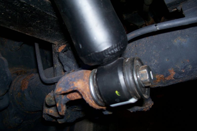

    So after pulling my mud filled skids I found this...

    Shoulda gave her a little wire brushing and a quick shot of rust paint while you were under there.

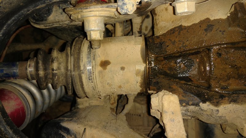

    image.jpg image.jpg image.jpg Well a few hours and 30$ later and its fixed.

    Seals pretty easy to replace. The needle bearing not so much if hes showing play.

    Hate those front diff oil seals at the cv

    Yep. PB Blaster is great stuff, but I've already found out what it can and can't do. I'm gonna take your advice and get a set on the way from wheelers.
    Were you able to reuse the shock bushing sleeves? I think I might have found some on summit, just in case.

    No sleaves used in the factory location.

    Another rookie question: It looks like I need the hourglass bushings with a 3/4" ID. Does that mean that the stock mounting bolt is around that diameter, or is there some slop between the bolt and the bushing?

    Hopefully that's not the case.
    I've got a spare set of OEM CVS I've been meaning to rebuild, guess this will get me on it.
    No shock bushing I can remember, but it's been awhile, your new shocks should come wit everything you need bushing wise.

    I have that same leak...bummer

    Make sure you've got oil, mine isn't bad, but it can drain the whole diff.

    New shocks should come with bushings if not use the factory ones. The mounting bolt is much smaller. Its only there to hold the washer and keep shock from sliding off the mount.
