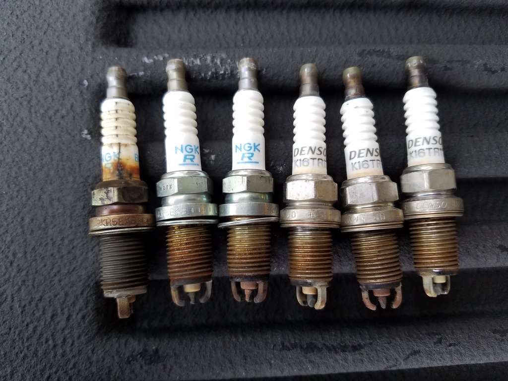

    At 160k my truck developed a nasty habit of sputtering under load. New plugs and wires today solved that issue.
    Pulled 3 Densos and 3 NGKs out which means these were likely the original set that came in the truck. I'll let you guys guess which one was connected to a coil that may be on its way out...
